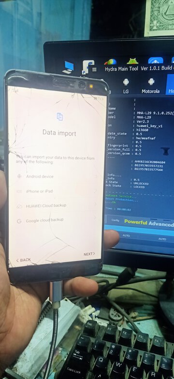

share lng mga idol.
MODEL: Huawei Mate 9 (MHA-L29)
PROBLEM: FRP
SULOTION: USE HYDRA

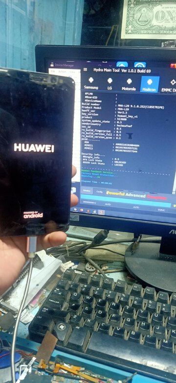

medyo makunat pero done sa tyaga....

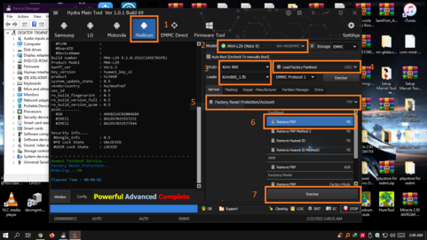

1. open your hydra main module at e update
2. select hisilicon/model-MHA-L29(MATE 9)
3.uncheck auto boot/kirin 960/kirin960_1.fb/load factory fastboot usb1
4. Factory Reset Protection/Account/Remove Frp/Execute

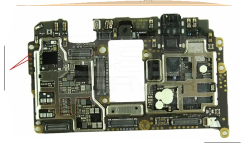

5. buksan ang unit at ikonek ang testpoint
see pic below
salamat sa pagview mga idol.......
see pic below
