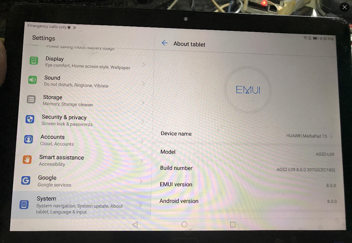

Hi
Unit: Huawei
Model: AGS2-L09
Problem: Gmail or Google account
Solution: Unlock Gmail using TP or via server pero mahal take up to 72hours
Paalala: napaka kunat yong ganitong model kaya ingat sa pag baklas ng LCD at sumingil ng naayon,
kayo na bahala mag hanap sa testpoint Position

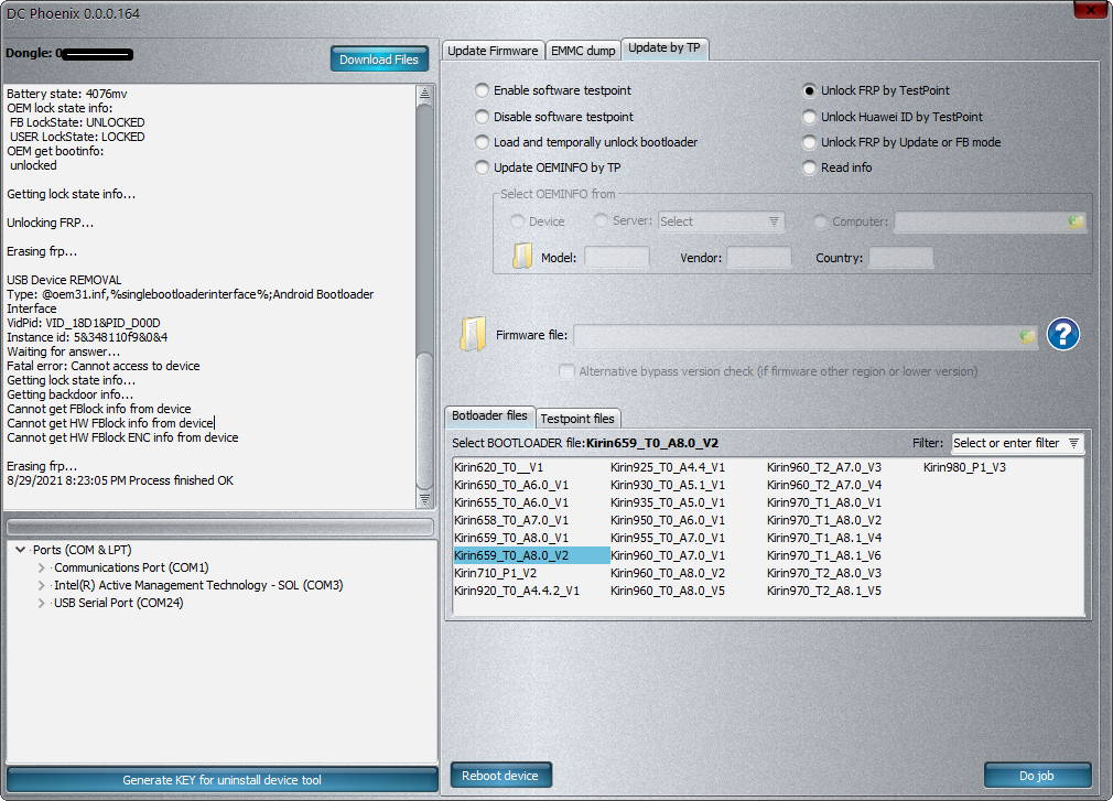

Tools i tried and Fails:
Octoplus FRP TOOL
Octoplus Huawei tool
MRT
UnlockTools
Steps:
  1. Open Device and DO the TP method
  2. Use DCPhoenix
  3. Update By TP
  4. Under Bootloader File Select "kirin650_T0_A8.0.V2"
  5. Turn Off device
  6. remove battery
  7. Connect TP
  8. Connect Battery
  9. Connect Cable
  10. In DCPhoenix
  11. Click DO The Job
  12. Done
DC Phoenix 0.0.0.164
user:0maxie
BOOTLOADER File to update: Kirin659_T0_A8.0_V2
Device detected:
COM3: HUAWEI USB COM 1.0 (COM3)
8/29/2021 8:22:26 PM Starting to load and unlock device...
Process identifier:33096186
Writing bootloader...
Step 1...
Step 2...
Waiting for device REMOVAL/INSERTION...
Waiting for fastboot device...
USB Device REMOVAL
Type: @oem65.inf,%qcomdevice00%;HUAWEI USB COM 1.0
VidPid: VID_12D1&PID_3609
Instance id: 5&348110f9&0&4
USB Device INSERTION
Type: @oem31.inf,%singlebootloaderinterface%;Android Bootloader Interface
VidPid: VID_18D1&PID_D00D
Device found: VQTBB20518100743
Looking for a device in fastboot mode
Getting IMEI...
Getting build number...
Build number is EMPTY
Getting model ...
Getting battery state...
Getting backdoor info...
Getting lock state info...
Getting lock boot info...
SN:VQTBB20518100743
IMEI:860037040583495
IMEI1:000000000000000
MEID:00000000000000
Build number: :
Model: AGS2-L09
Vendor/Country: hw/meafnaf
Battery state: 4076mv
OEM lock state info:
FB LockState: UNLOCKED
USER LockState: LOCKED
OEM get bootinfo:
unlocked
Unlocking FRP...
Erasing frp...
USB Device REMOVAL
Waiting for answer...
Fatal error: Cannot access to device
Cannot get FBlock info from device
Cannot get HW FBlock info from device
Cannot get HW FBlock ENC info from device
Erasing frp...
8/29/2021 8:23:05 PM Process finished OK
