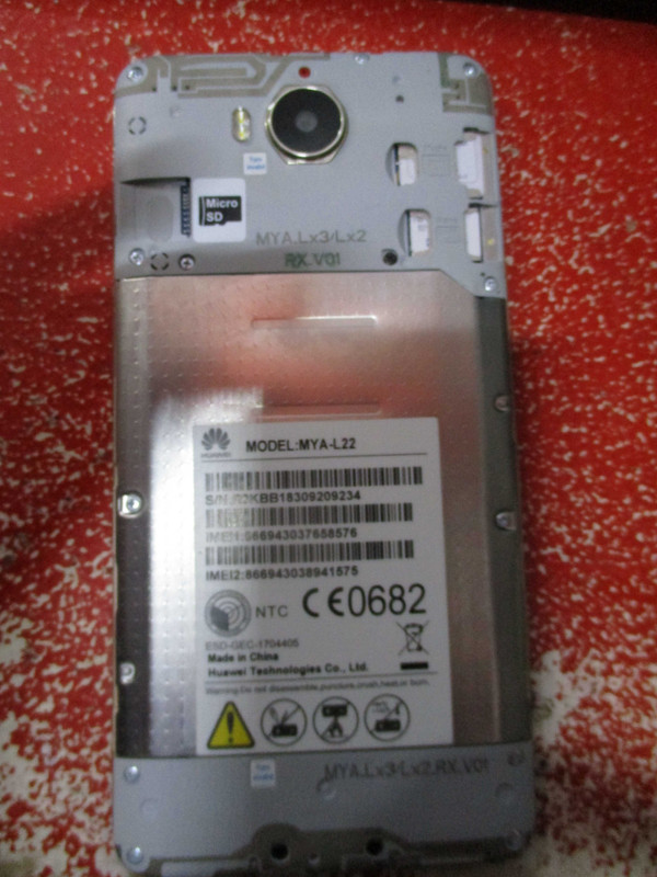

REFERENCE Huawei MYA-L22 FRP done by MRT

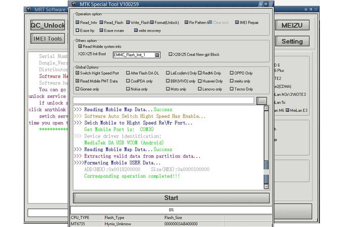

Procedure:
OPEN MRT Tool
SELECT MTK Tool
CLICK START and Pres VOL DOWN
SALPAK USB...

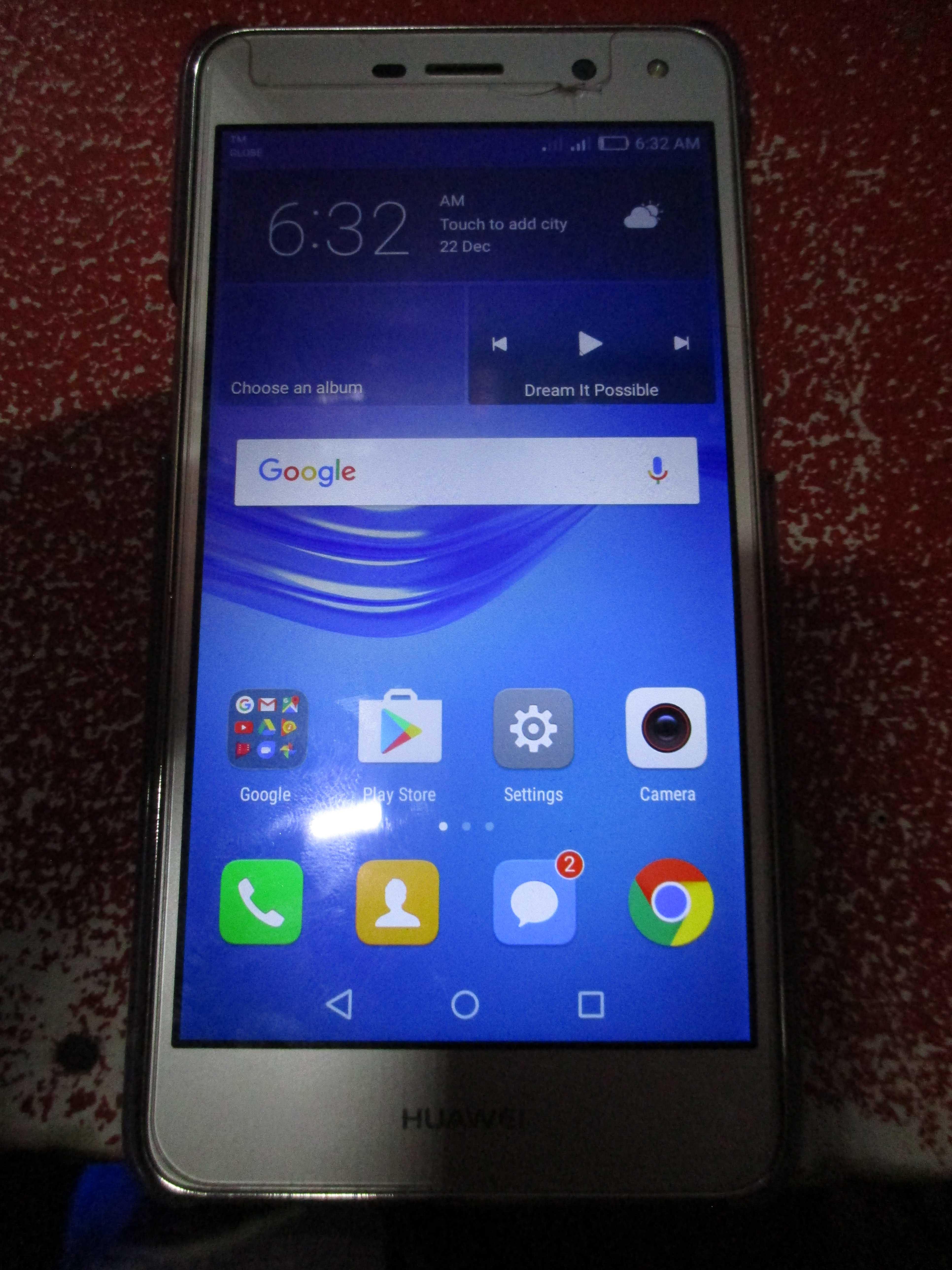

Done na mga ka ants....thanks lang sa viewers...
