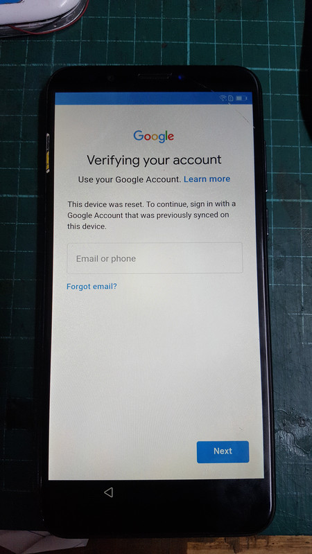

Problem:
pattern & Frp

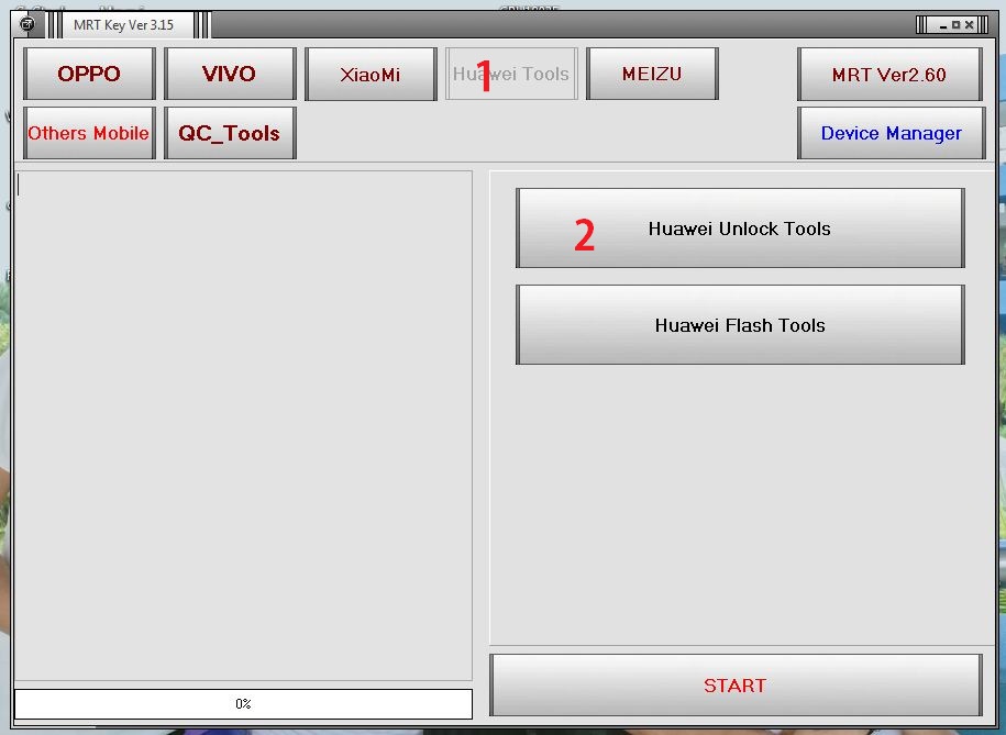

open mrt v3.15
then click lang ang tab na ito
huawei tools, then Huawei unlock tools

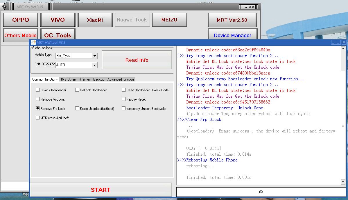

then lalabas un MRT HUAWEI TOOLS V3.3
tick remove frp lock then click start button
press vol down tapus salpak un usb cable para pumasok sa fastboot mode

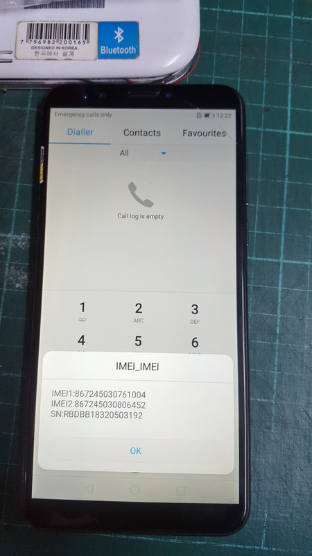

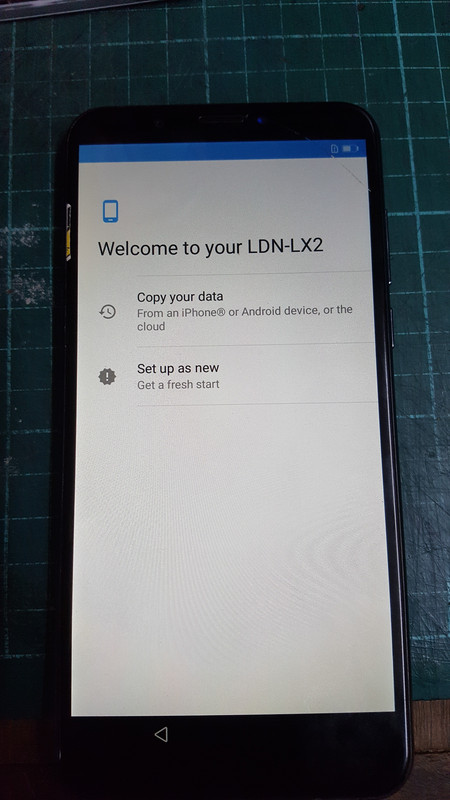

finish na..
100% tested by me isang like lang happy na me..hehehe
