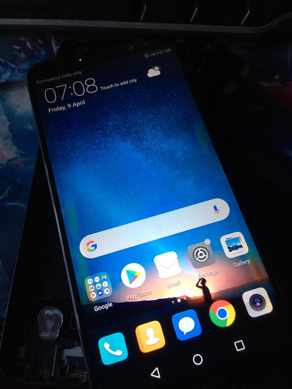

share lng poh frp bypass using hydra tools
halos nabaliw ako pero nadali din
model RNE-L22 8.0.0.356(c636)

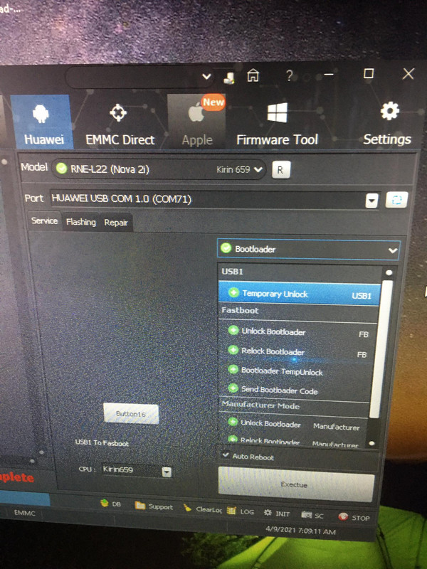

1.open hydra main select your model
test point poh yan para madetect usb1
2.click nio button 16
3.select bootloader and usb1 temporaryly unlock then click execute
4.mag rereboot yan s fastboot mod3
5.then palitan nio yun bootloader ng factory reset protection/account
6.meron dyan fastboot mode piliin mo remove frp then check auto reboot and click execute wait mlng matapos mag foformat yan.
7.tapos na yan alam nio na gagawin dyan
done sana makatulong poh
