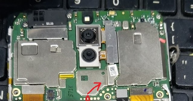

hello po mga sir good evening po sainyo nais ko lang po mag share ng idea rito
The software i used is not free but if you are interested : MRT 3.77 Premium Crack
Brand: Huawie
Device Name: Nova 2i
Model: RNE-L22
Procedure
1. open mrt 3.77
2. Tick Huawei Tools
3. Then Huawei Flash Tools
4. Tick USB COM 1.0
5. Select
CPU Type: hisi 659
Port: Auto
after dito is mag automatic fastboot mode ang unit at pag naka fastboot na po ang unit
Tick Unlock Account, Select Erase Frp, then Tick Start. Done!
