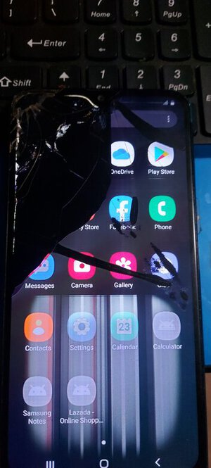

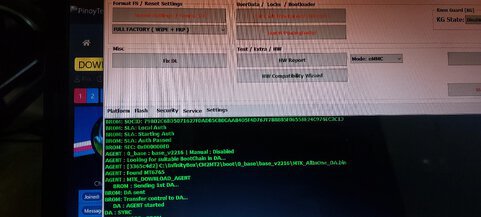

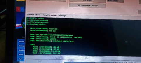

samsung a10s frp remove via cm2mt2
1 open cm2mt2
2 select only 0 base
3 full facortory (wipe data)
4 hit format setting/formtmat fs

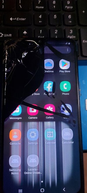

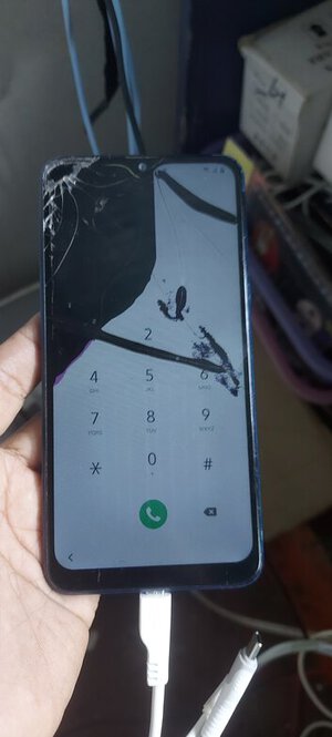

pasensya na basag lcd pa kuha dw muna ni tomer frp bago nya bilhan lcd..
