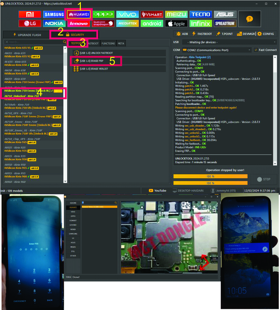

1. open UT--- select Huawei+security+testpoint
2. select-- HiSilicon Silicon kirin 710 Emmc [Unlock BL]
3. connect the phone via testpoint
4. [USB 1.0] ERASE FRP
5. read carefully=== Disconnect device and enter testpoint agin
6. ERasing FRP OK...... DoneView attachment 32647tested idol salamat sa binahagi mo ;)
