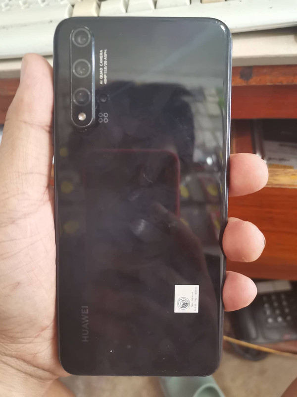

Huawei Nova 5T YAL-L21 FRP DONE MRT

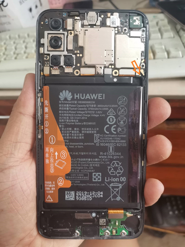

Needed:
MRT
TWEZZER
Usb Cable
BAKLASIN ANG UNIT AT
TESPOINT

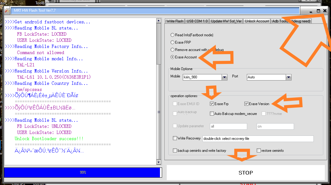

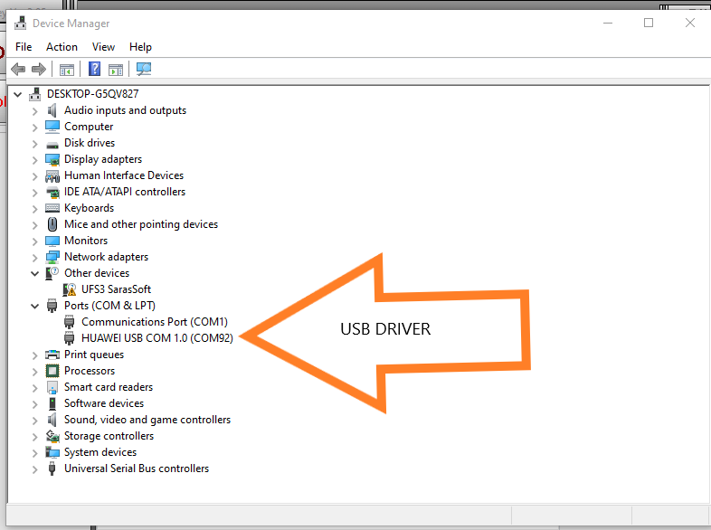

Procedure:

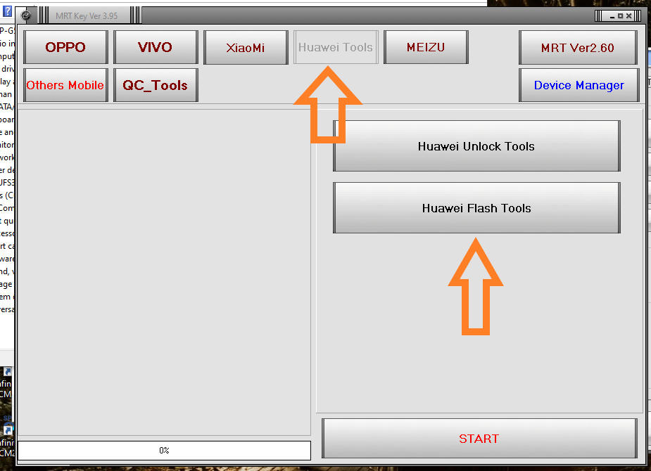

1. MRT V3.95
2. HUAWIE TOOLS
3. HUAWIE FLASH TOOLS
4. HUAWIE ACCOUNT
5. ERASE ACCOUNT

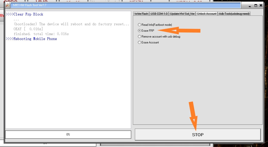

6. ERASE FRP
7. ERASE VERSION
8. START AFTER START 99% LANG YAN KAYA
EXIT MO UNG MRT HW FLASH TOOLS VER 7 7
WAG MONG DESCONECT UNG CP HAYAN MO LANG
NANAKA CONECT SA PC
9. AFTER EXIT OPEN MO ULIT UNG
MRT HW FLASH TOOL VER 77 TAPOS

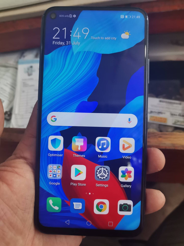

UNLOCK ACCOUNT ERASE FRP START
HAYAN MO LANG AUTOMATIC NA MAG UNLOCK YAN
