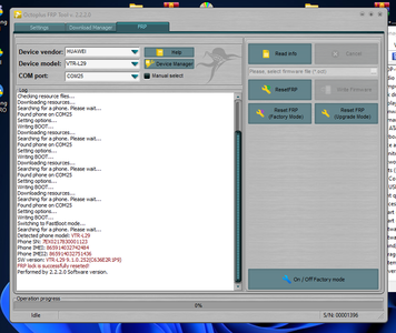

share kolang natangap kong huawei p10 vtr-l29 frp problema
remove tp via octo frp tools
1.OPEN OCTO FRP TOOLS
2.SELECT MODEL HUAWIE VTR-L29

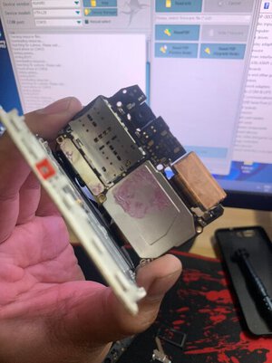

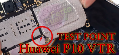

3.BAKLASING ANG PHONE PARA MAG TP
NOTE BAGO MAG TESTPOIN REMOVE BATTERY
AFTER MA DETECT NA ANG PHONE BALIK MO ANG BATTERY

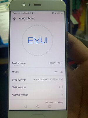

ITO PO ANG RESULT PLS LIKE KUNG NAKA TULONG SAYO SALAMAT 310295631_829278198215692_6005839890520050179_n.jpg313792446_1092659801421580_754689101598415127_n.jpgscreenshot_21.pngscreenshot_22.png
