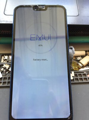

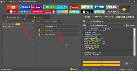

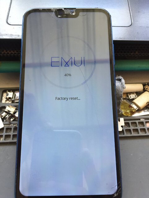

procedure:
power off phone
open the back of phone
connect testpoint
connect usb
install drivers (install hisuite for me for auto install drivers)
select huawei usb com 1.0 port on UT
select HiSilicon kirin 659 usb 1.0
then click remove frp/huawei account
and done!
tp :
TOOL :
logs:
[USB 1.0] ERASE FRP Scanning port... COM9
Connecting to port... OK
Connection : USB 1.0 Full-Speed
USB Driver : [HUAWEI Incorporated] HSPL_usbvcom
Selected Model : HiSilicon Kirin 659
Code Name : Hi659
Operation : Kirin Testpoint [1]
Authenticating... OK
Retrieving data... OK [1.04 MiB]
Platform : HiSilicon Kirin 659
Writing sec_usb_xloader... OK 0.493s
Writing sec_fastboot... OK 24.834s
Waiting for fastboot... OK

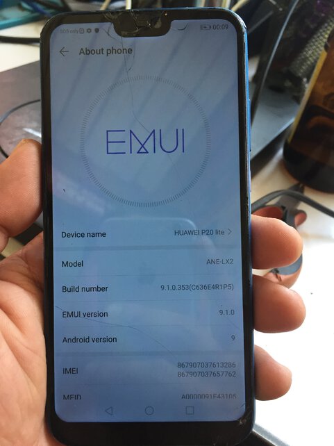

Product Model : ANE-LX2

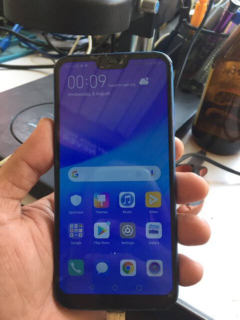

Erasing FRP... OK
UNLOCKTOOL 2022.12.11.0
Elapsed time : 35 seconds
