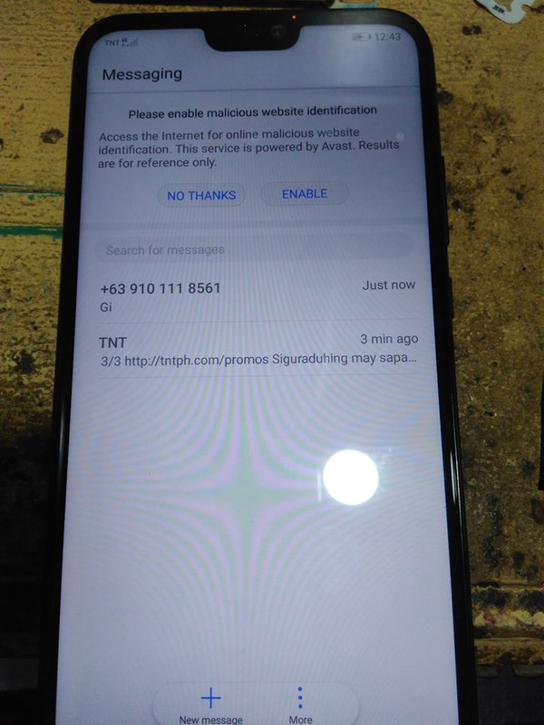

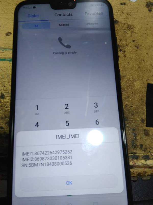

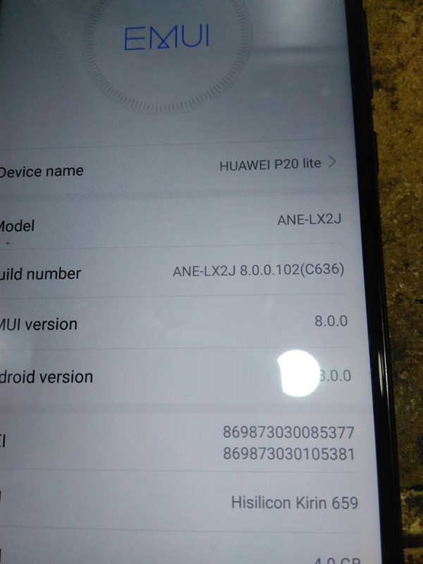

FIRST SA ANTGSM....GOOD PM SALAHAT SHARE KULANG ETO SA INYO HUAWEI P20 LITE ANE-LX2J HNDE MAKADAWAT TXT HNDE POD MATAWAGAN.KAHIT NA FULL REST KONA WALA PARIN UUBRA KAHIT G DIRECK UNLOCK KONA SA CHIMERA TOOL WALA PARING NAGHAHANAP AKO SAKTO FW AT BUILD NIYA PERO WA AKO MAKITA.KAYA NAG IISIP AKO MAIGE OPEN KO OLIT CHIMERA TOOL KO

YAN PO KANYAN IMEI

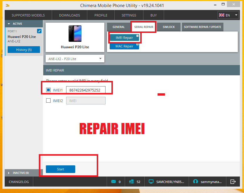

OPEN CHIMERA TOOL

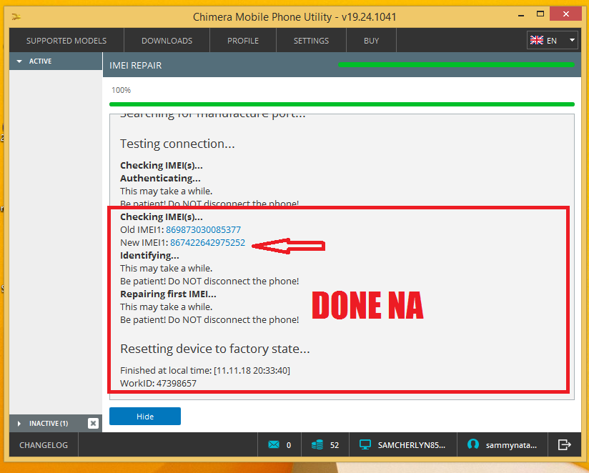

PAG CLICK SA START HINTAY LANG
DONE NA KAYA TRY KO TXT
YON MAKA RECEIVE NA ETO NA IMEI
DONE NA SALAMAT SA PAG VIEW
