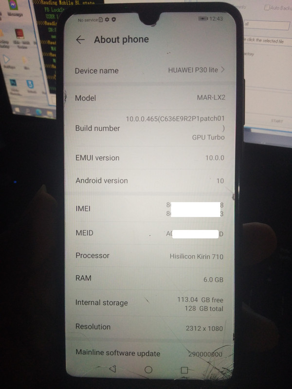

Huawei P30 Lite (MAR-LX2) Android 10

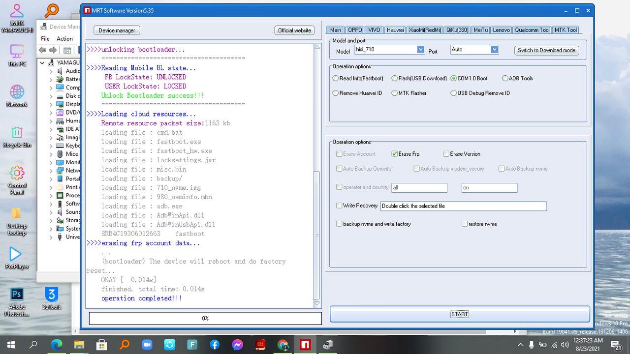

1: open mrt v5.35
2:click Huawei tab
3:select model (hisi 710)
4:click COM1.0 Boot and check Erase Frp

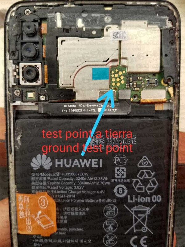

5:turn off and testpoint then insert USB type C
6:wag tangalin ang battery habang naka TP para walang error sa pag reboot to fastboot
Huawei usb com 1.0 Driver Here
PROCEDURE: pakisundan sa baba

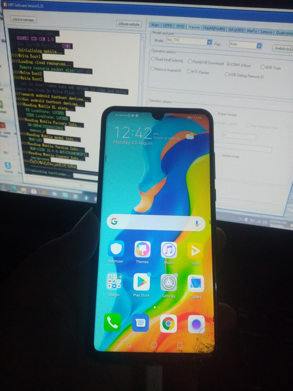

LOGS
>>>>Device Driver name:
HUAWEI USB COM 1.0
>>> Get the COM Port is: COM5
Initializing mobile...
>>>>Write Boot1
>>>>Loading cloud resources...
Remote resource packet size:4400 kb
>>>>Write Boot2
>>>>Write Boot3
all is done!!!make sure adb driver is come,and write update.app flash By Write Flash !!!
>>>>search android fastboot devices...
>>>>Get android fastboot devices...
>>>>Reading Mobile BL state...
FB LockState: LOCKED
USER LockState: LOCKED
>>>>Reading Mobile Factory Info...
SN:8RB4C19306012663
memcpy_s
>>>>Reading Mobile model Info...
MAR-LX2
>>>>Reading Mobile Version Info...
MAR-L22B 10.0.0.465(C636E9R2P1)
>>>>Reading Mobile Country Info...
hw/spcseas
>>>>ÕýÔÚ¶ÁÈ¡É豸µÄÊÚȨÐÅÏ¢
>>>>unlocking bootloader...
FB LockState: UNLOCKED
Unlock Bootloader success!!!
Remote resource packet size:1163 kb
loading file : cmd.bat
loading file : fastboot.exe
loading file : fastboot_hw.exe
loading file : locksettings.jar
loading file : misc.bin
loading file : backup/
loading file : 710_nvme.img
loading file : 980_oeminfo.mbn
loading file : adb.exe
loading file : AdbWinApi.dll
loading file : AdbWinUsbApi.dll
8RB4C19306012663 fastboot

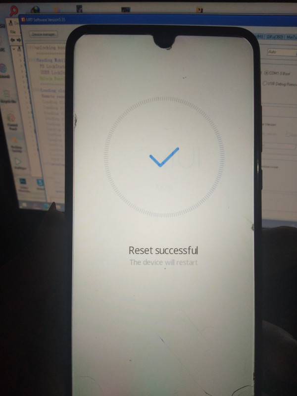

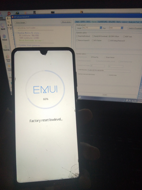

>>>>erasing frp account data...
(bootloader) The device will reboot and do factory reset...
OKAY [ 0.014s]
finished. total time: 0.014s
operation completed!!!

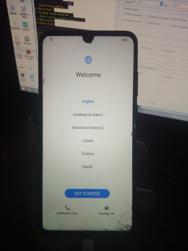

kapag huawei master kadalasan akong nakikita hindi na tinatanggal ang battery para madetect ang usb com..
salamat sa idea sir. pero natry ko na lahat ayaw pa rin
Open File Fail!!!D:\MRT_Software\android.zip
can not get any fastboot devices;please check driver,and click start again,not need into COM1.0 again!!!
drivers bro check mo baka di na install yung COM1.0 at fastboot need talaga yang dalawa para mag reboot cya sa fastboot mode
sige sir. install ko hisuite. hirap lang talaga dahil laging "check your network" lagi
