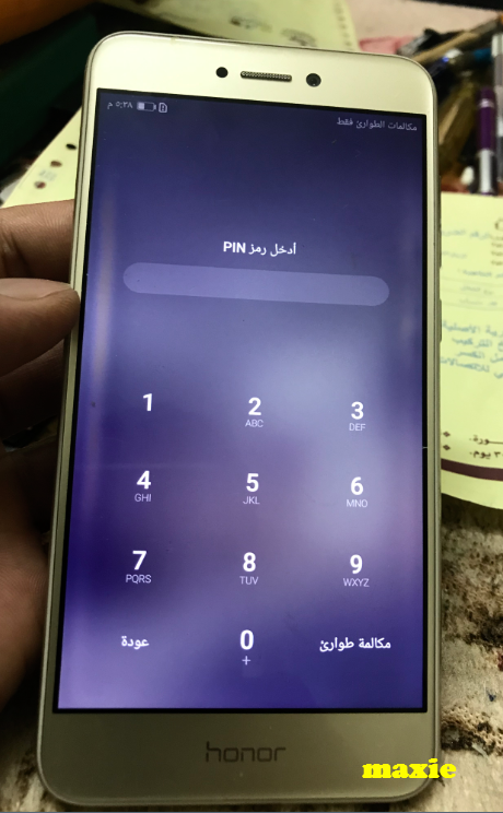

Hi
Unit: Huawei
Model:PRA-LA1
Problem:FRP
Solution: Unlock via HCU
Procedure:
Logs
Finish
Thanks button lang sapat na
Unit: Huawei
Model:PRA-LA1
Problem:FRP
Procedure:
- Turn off phone
- Press and hold "Vol -"
- Insert Usb cable
- Phone will go to fastboot mode
- Done
Logs
Before detection connect cable to usb and enable Manufacture mode !
Qualcomm and HiSilicon: *#*#2846579#*#*
MTK: *#*#14789632#*#*
Windows: ##2846579#
ProjectMenu
1.Background setting
2.USB ports setting
Select Manufacture mode
2019-01-15 17:41:59.569 Start read phone info from fastboot!
2019-01-15 17:42:00.657 Read phone info done!
Model: PRA-LA1
IMEI: 864464033285712
Firmware ver.: PRA-LA1C185B185
SN: HGH4C17325006536
2019-01-15 17:42:00.712 Phone info data backup saved to file C:\Users\maxie\Downloads\Compressed\HCU_287\Backup\20190115_174200_864464033285712.BAK
IMEI1:864464033305726
FB LockState: LOCKED
USER LockState: LOCKED
locked
Battery state: 3812mv
2019-01-15 17:42:02.919 Checking account 013maxie...
2019-01-15 17:42:02.934 Connecting to server...
2019-01-15 17:42:03.383 Connected!
Account: 013maxie
Check success!
Credits left: 11
Dongle support till 1/19/2038
2019-01-15 17:42:11.984 Erase FRP start
2019-01-15 17:42:12.323 Connecting to server...
2019-01-15 17:42:12.773 Connected!
2019-01-15 17:42:16.730 Reading phone info...
2019-01-15 17:42:17.217 Read phone info success!
Model: PRA-LA1
2019-01-15 17:42:17.312 Phone info data backup saved to file C:\Users\maxie\Downloads\Compressed\HCU_287\Backup\20190115_174217_864464033285712.BAK
2019-01-15 17:42:17.322 Reading Certify data...
2019-01-15 17:42:17.761 Reading Certify data success!
2019-01-15 17:42:17.771 Signing Certify data...
2019-01-15 17:42:19.974 Erase FRP done!
Finish
