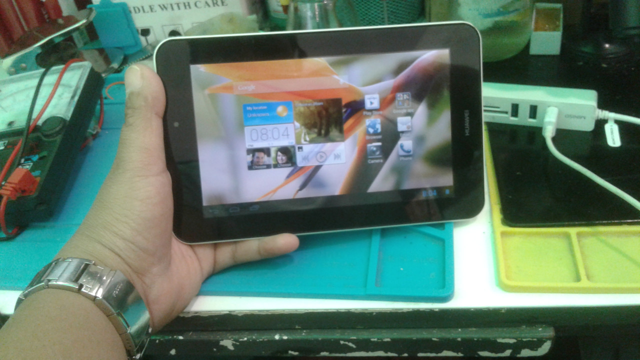

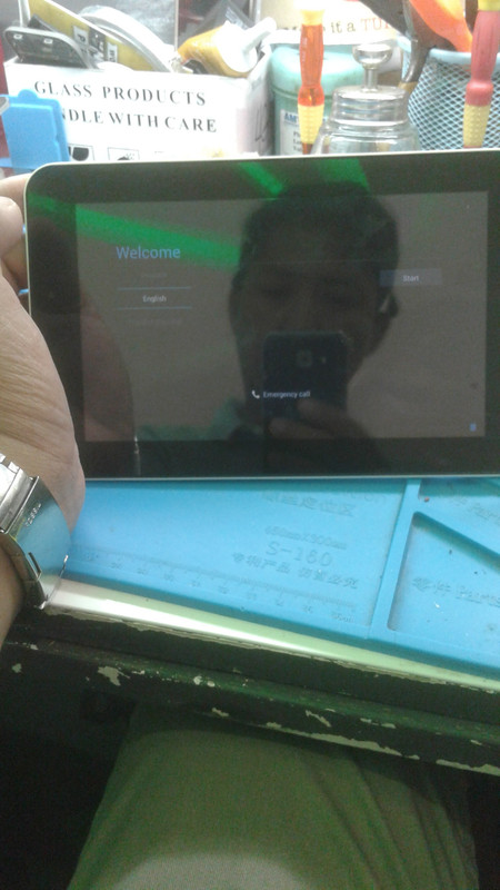

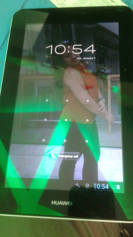

for reference lng...
Huawei s7-701u pattern lock
solution..

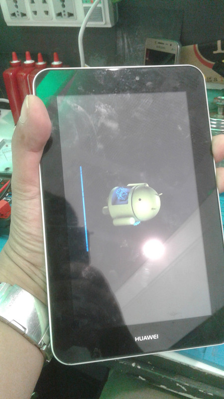

press and Hold POWER BUTTON + VOLUME UP +VOLUME DOWN
When vibrate the tablet release Power Button.
You see ANDROID image then RELEASE Volume Up
you will see the android image with running lines
Still Hold Volume Down then waiting
after few second screen show up OK and your Done now! release vol down now
Be patient when rebooting it takes 5-10 minutes
done...
