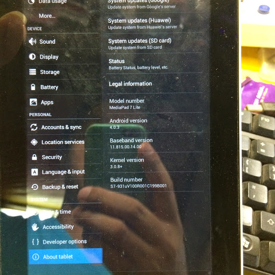

1.Power-Off your tablet
2.Press the three buttons (power + volume up + volume down.)
3.Release the power button when you see the logo and keep pressing the two buttons till you see the gear.
4.Release the volume up without releasing the volume down.Wait till you see a yellow bar under the gear then you can release it.

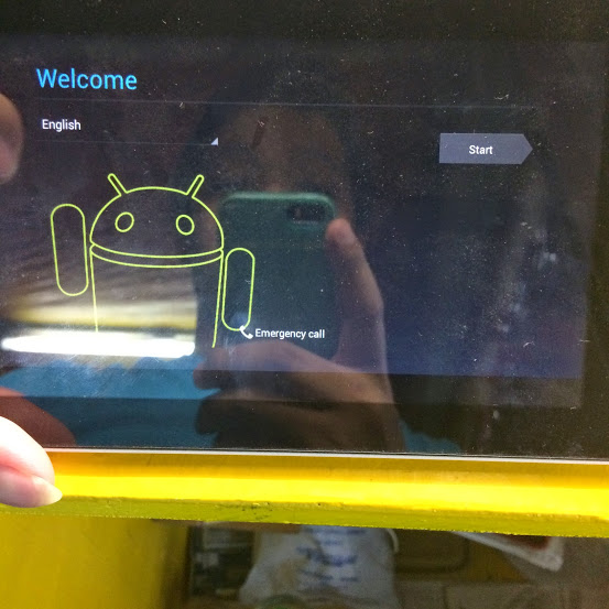

wait till the display says OK and thats it,your tablet now will reboot and wait until completely power on.
5.Follow on screen to continue using tablet
