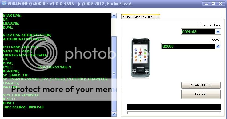

Unit:
Huawei u2800
Status:
Network locked
Tools:
FG pack5
5310 usb cable
Procedure:
-Install u2800 usb driver
-open Qualcomm tool pack 5
-tick scan ports
-select operation unlock
-tick do job
Ito po screenshot:
Ito po finished product:

Huawei u2800
Status:
Network locked
Tools:
FG pack5
5310 usb cable
Procedure:
-tick scan ports
-tick do job
Ito po screenshot:
