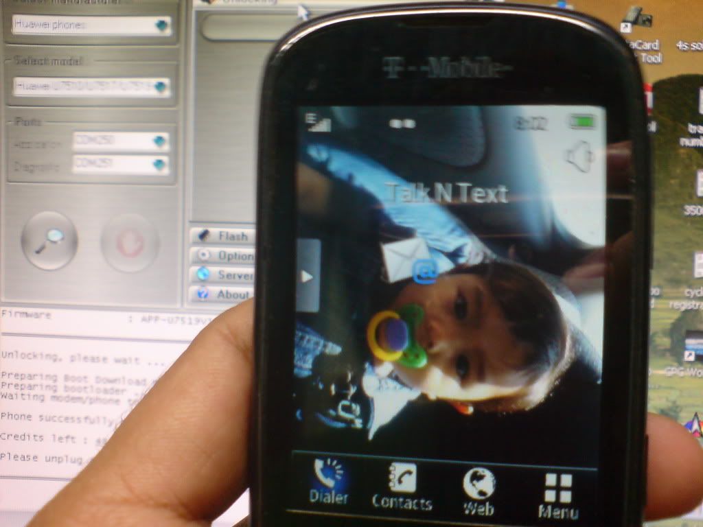

share ko lang mga boss....
procedures here:
Turn on phone.
Connect it to computer via USB cable.

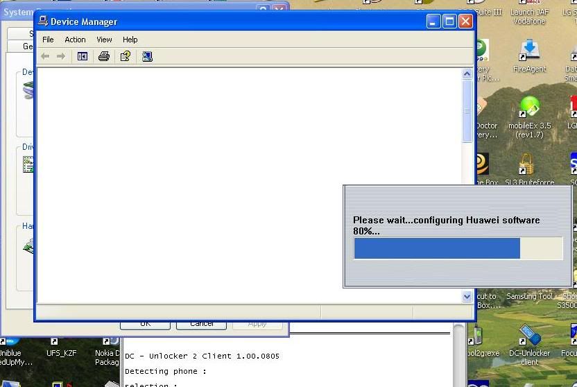

Wait till all drivers are fully installed and phone appears in "Modems" and "Ports" sections in Device Manager.
Then launch DC-Unlocker.
Open Server tab, enter username and password that you received after credits purchase (you can buy credits here: www.dc-unlocker.com/buy ) and click "Check login"
If DC-Unlocker/Vygis/Rocker dongle is connected, do not enter username and password, only click "Check login".

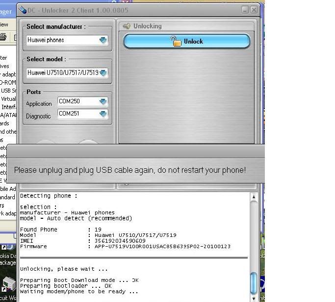

Select Manufacturer: Huawei phones, model leave Auto detect(recommended).
Click on "Detect" button (big magnifying glass).
Wait till phone will be fully detected.

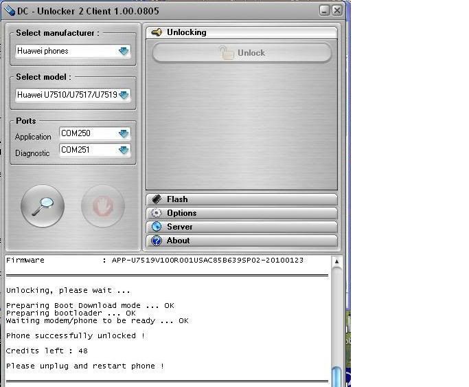

Open Unlock tab, click "Unlock".

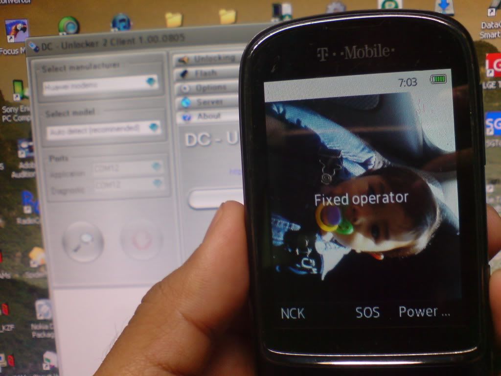

When you see that phone is successfully unlocked, remove battery and restart phone.
finally..
happy unlocking
