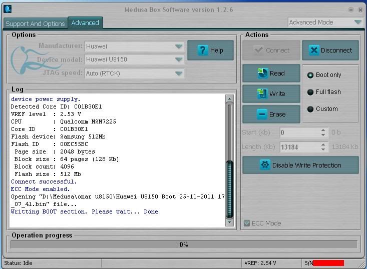

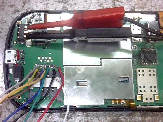

solder all jtag pinout properly
write this HUAWEI U8150 ULNOCKED BOOT FILE (BOOT ONLY)
perform a hard reset by holding END CALL + VOLUME UP + POWER ON KEY

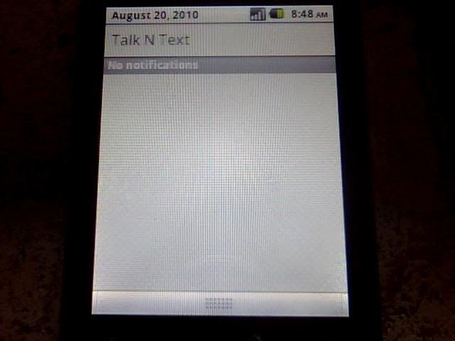

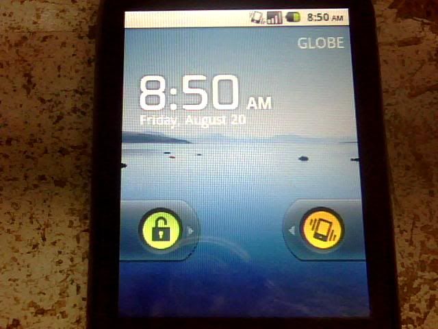

your EDIOS is now UNLOCKED to all network
in case of NO NETWORK SERVICE after this procedure

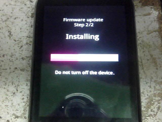

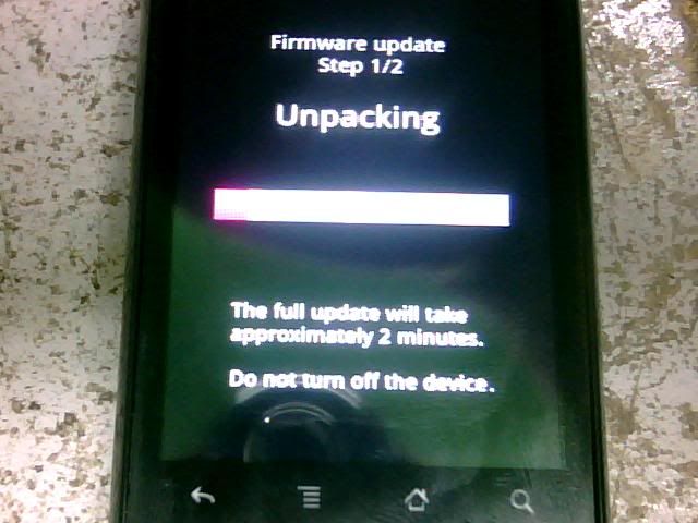

please download this HUAWEI U8150 T_MOBLIE STOCK ROM with attached procedure to solve no service problem after unlock
