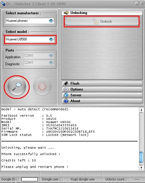

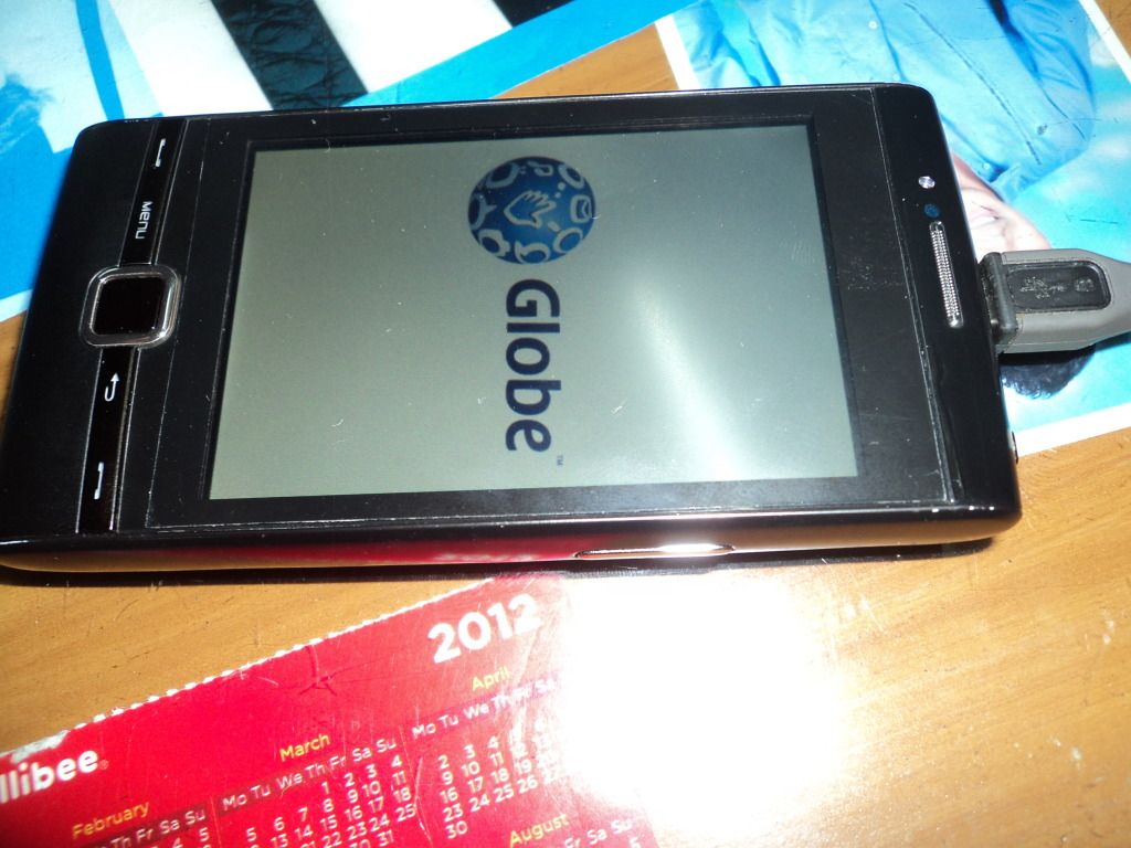

Model: Huawei U8500 (Globe) locked.
cable: use usb micro
Driver: " U8500 Driver "
Procedure:
Press vol. down + end call + pow. on key and Insert usb micro cable..
install driver needed..
open dc client and select model..
click scan to detect phone.
click Unlock and wait....
Done.
Logs:
Code:
model - Auto detect (recommended) Fastboot version : 0.5 Product : U8150 Model : Huawei U8500 IMEI : 353026043335650 Serial NR. : 7XA7NC1210611616 Firmware : U8500V100R001C00B718_EFS SIM Lock status : Locked (Network lock) ================================================= Unlocking, please wait ... Phone successfully unlocked ! Credits left : 50 Please unplug and restart phone !
