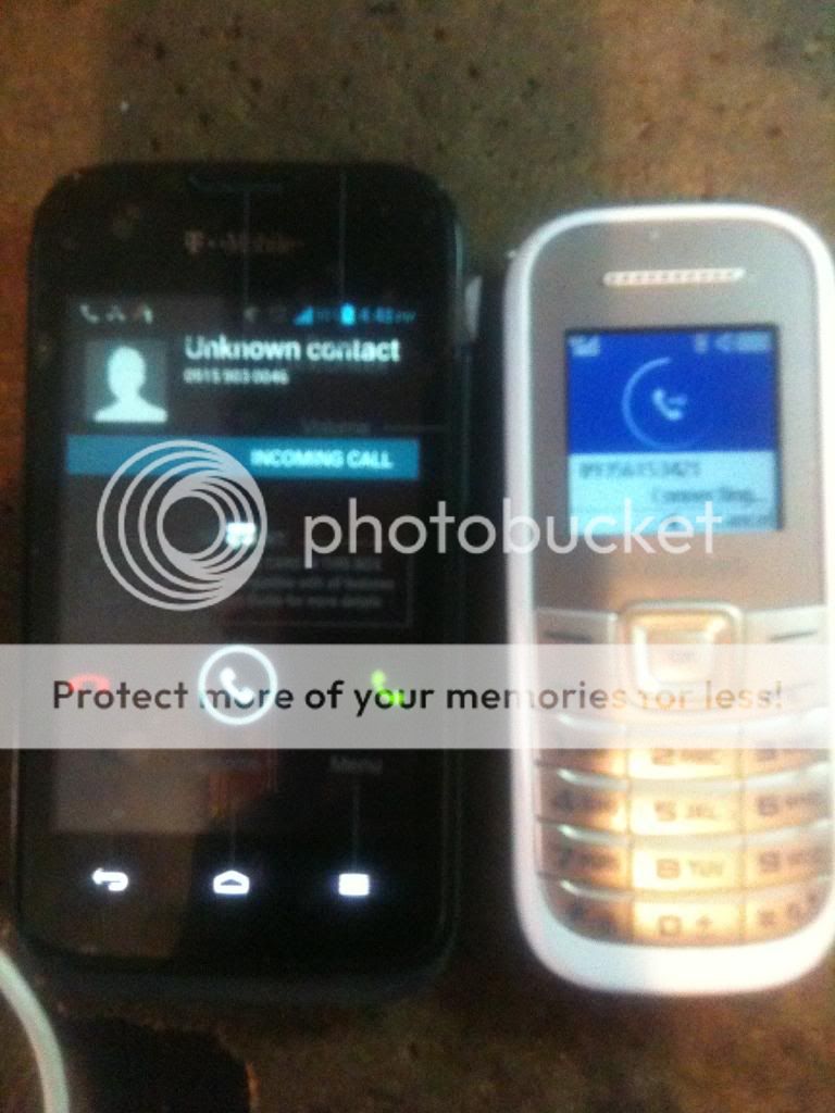

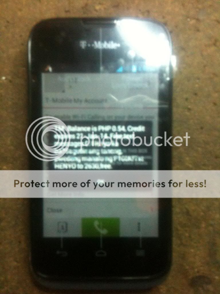

ito po pic......

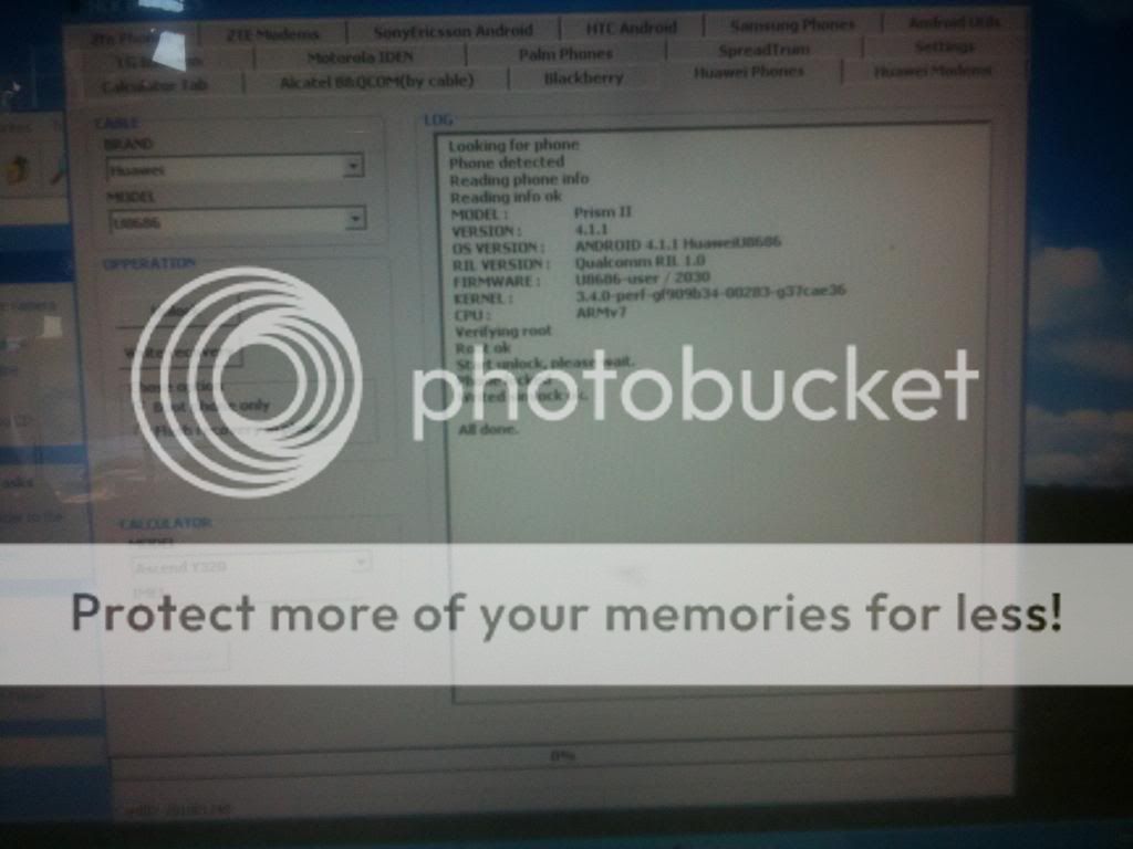

logs......................
Looking for phone
Phone detected
Reading phone info
Reading info ok
MODEL : Prism II
VERSION : 4.1.1
OS VERSION : ANDROID 4.1.1 HuaweiU8686
RIL VERSION : Qualcomm RIL 1.0
FIRMWARE : U8686-user / 2030
KERNEL : 3.4.0-perf-gf909b34-00283-g37cae36
CPU : ARMv7
Verifying root
Root ok
Start unlock, please wait.
Phone locked
Writed simlock ok.
All done.
