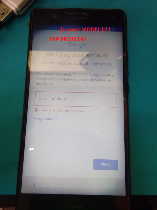

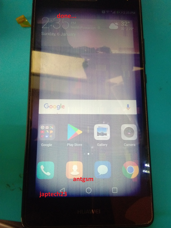

huawie model L21 FRP DONE..
DINALA ni tumer naka frp na
kaya salang agad sa MRT dongle

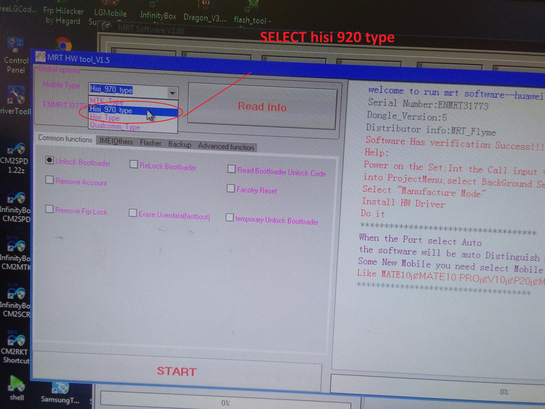

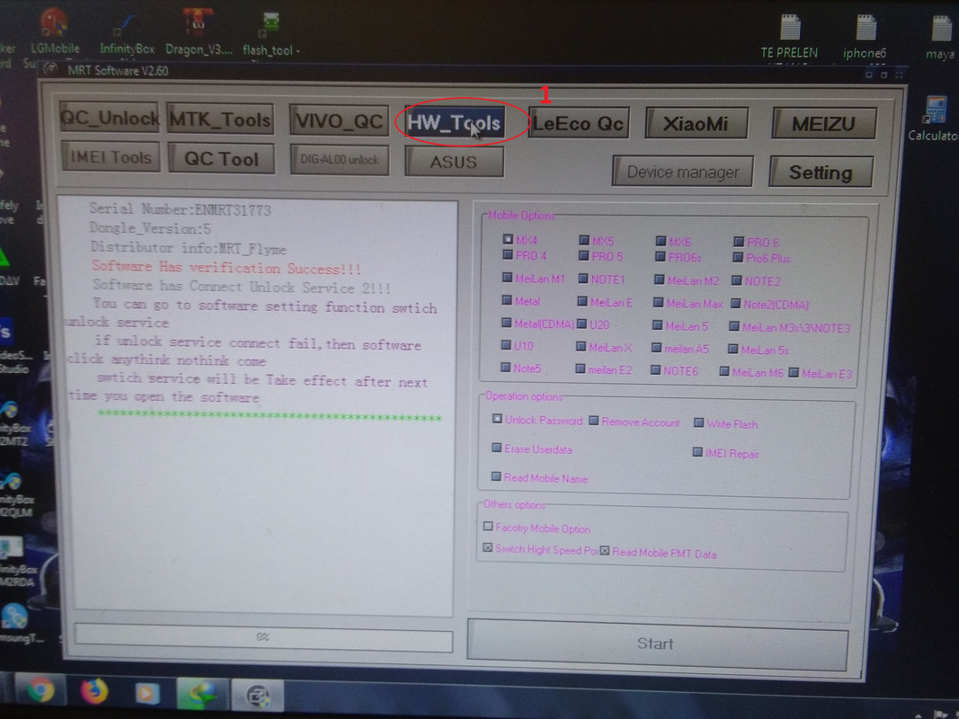

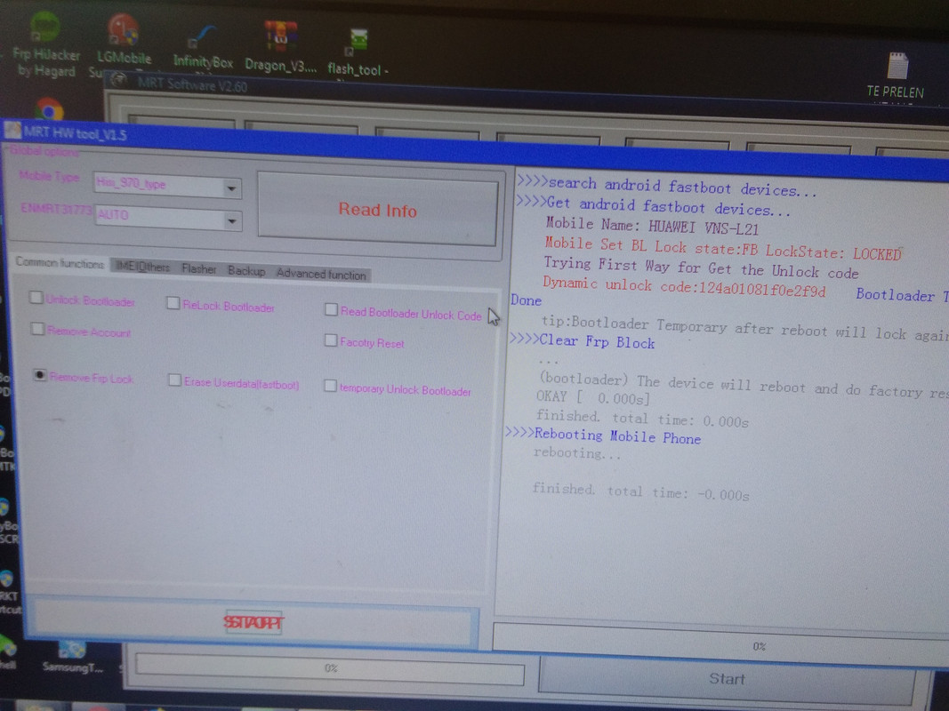

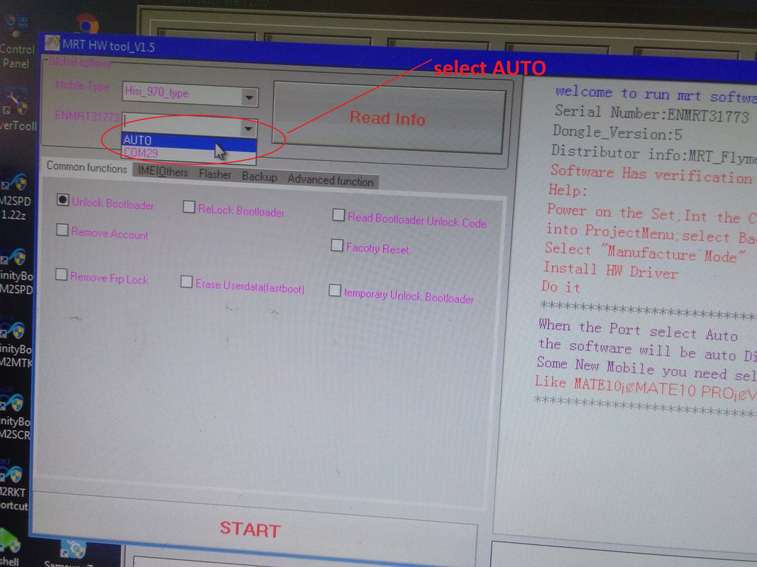

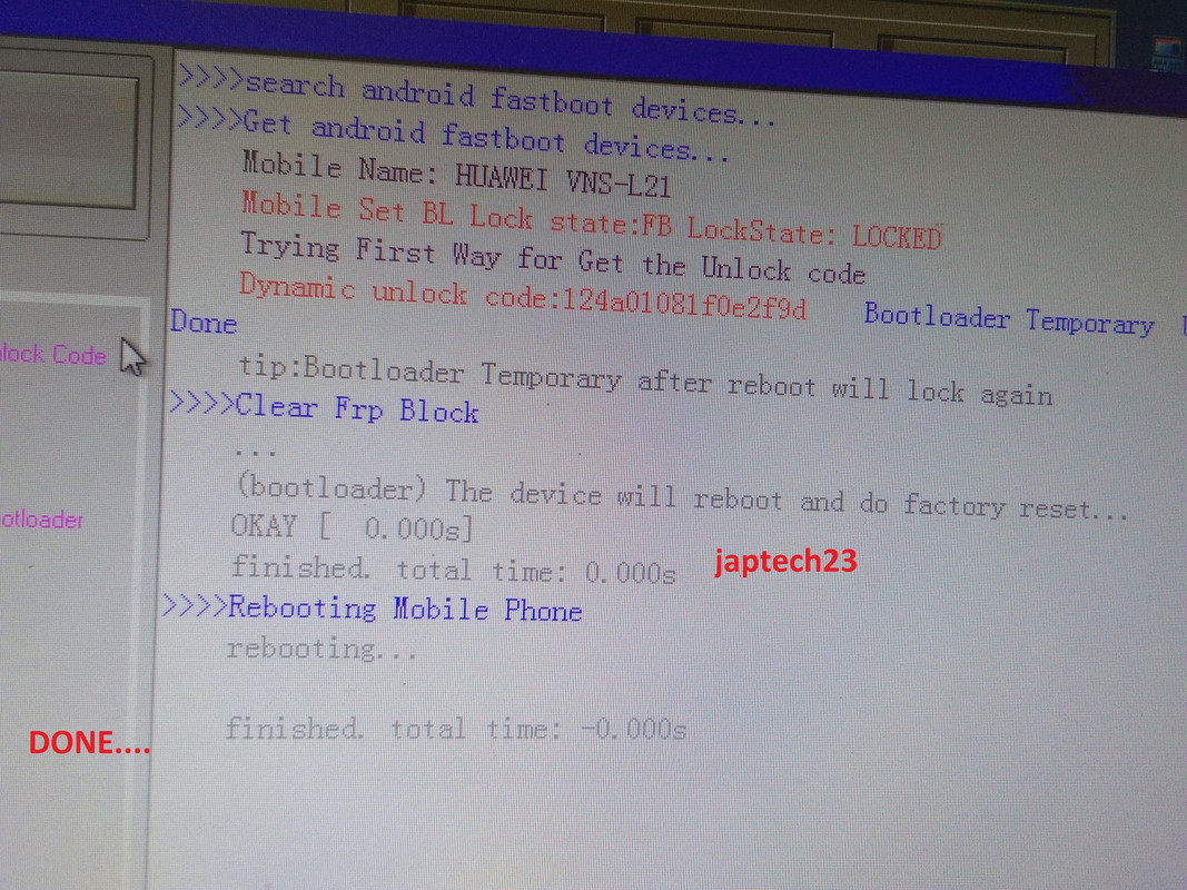

Una ifastboot mode ang Huawei P9 ( hold vol down at salpak ang SA PC ) 5 sec.
antayin mo lng magfastboot yan
Open Mrt tool GUI
SUNDAN LANG ANG NASA PICTURE MGA BOSS...
screen shot tool
moira brown ghoul
DONE...

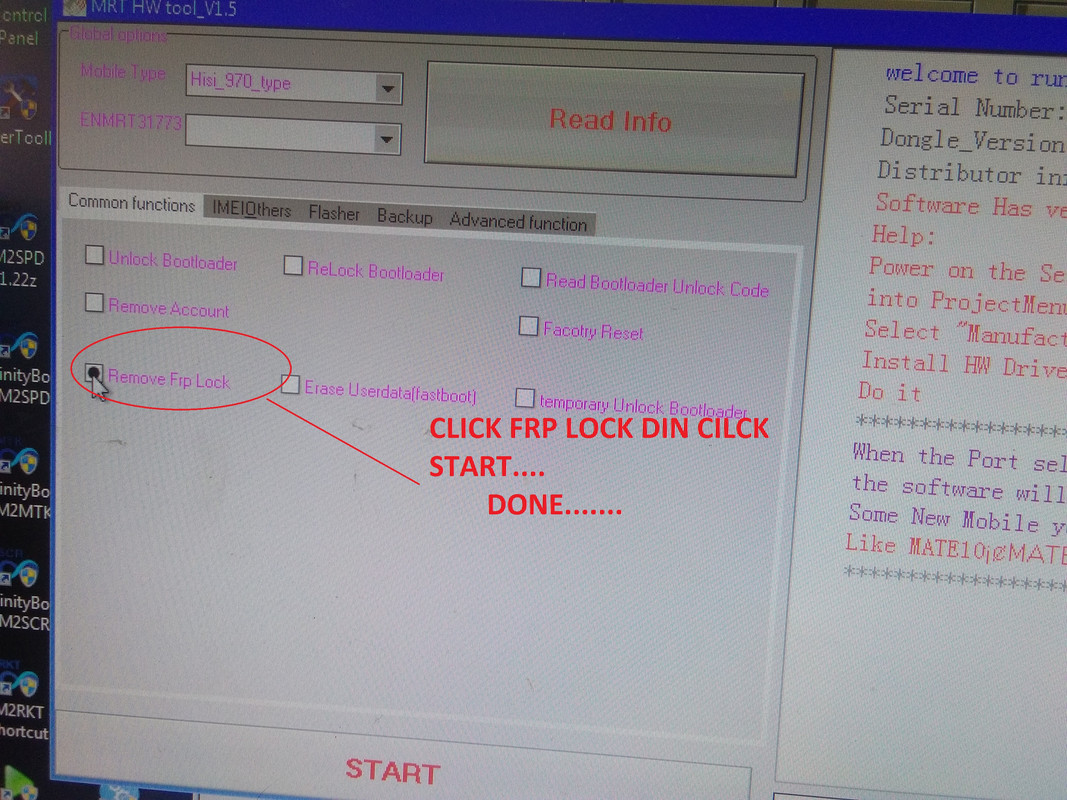

Open Mrt tool GUI
screen shot tool
moira brown ghoulDONE...
