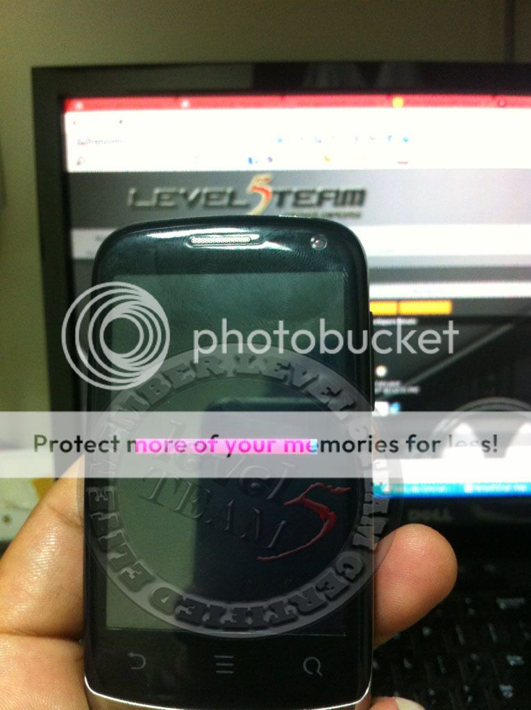

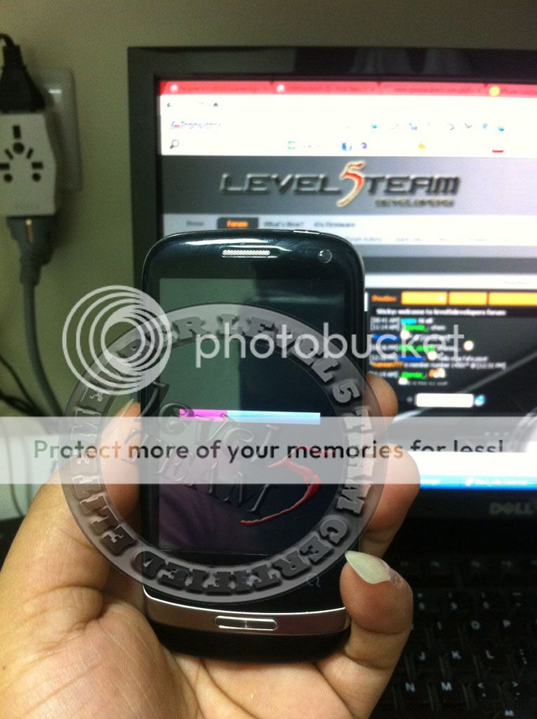

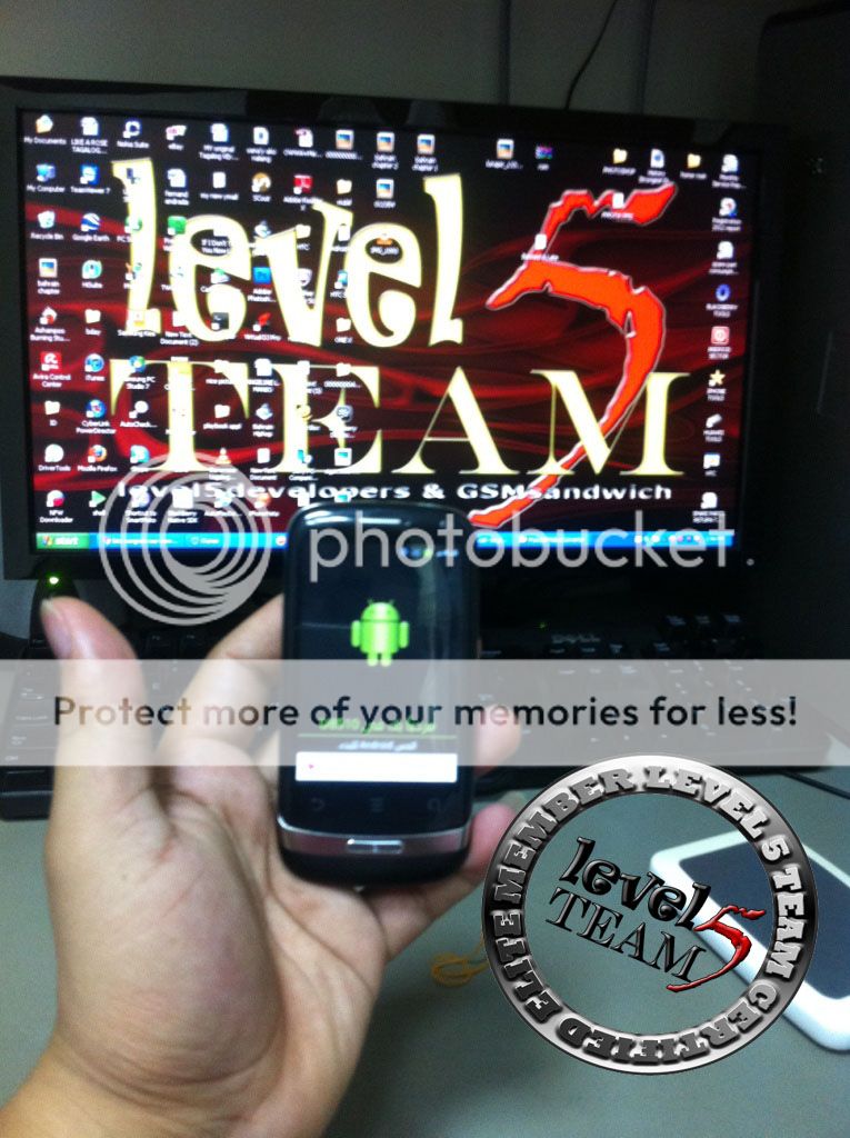

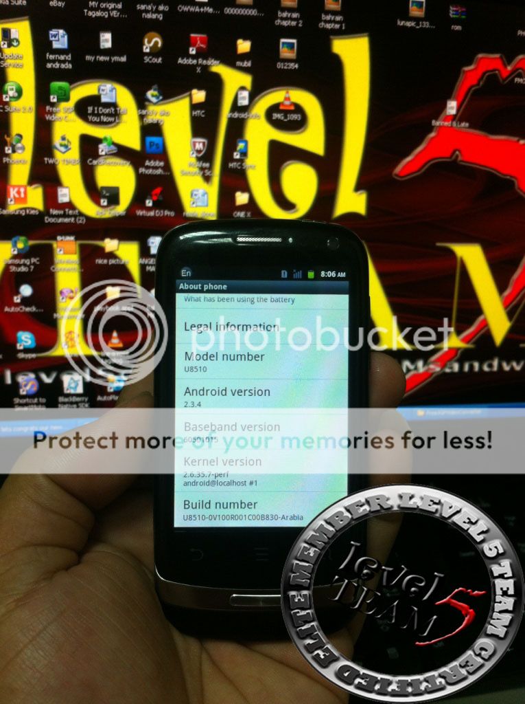

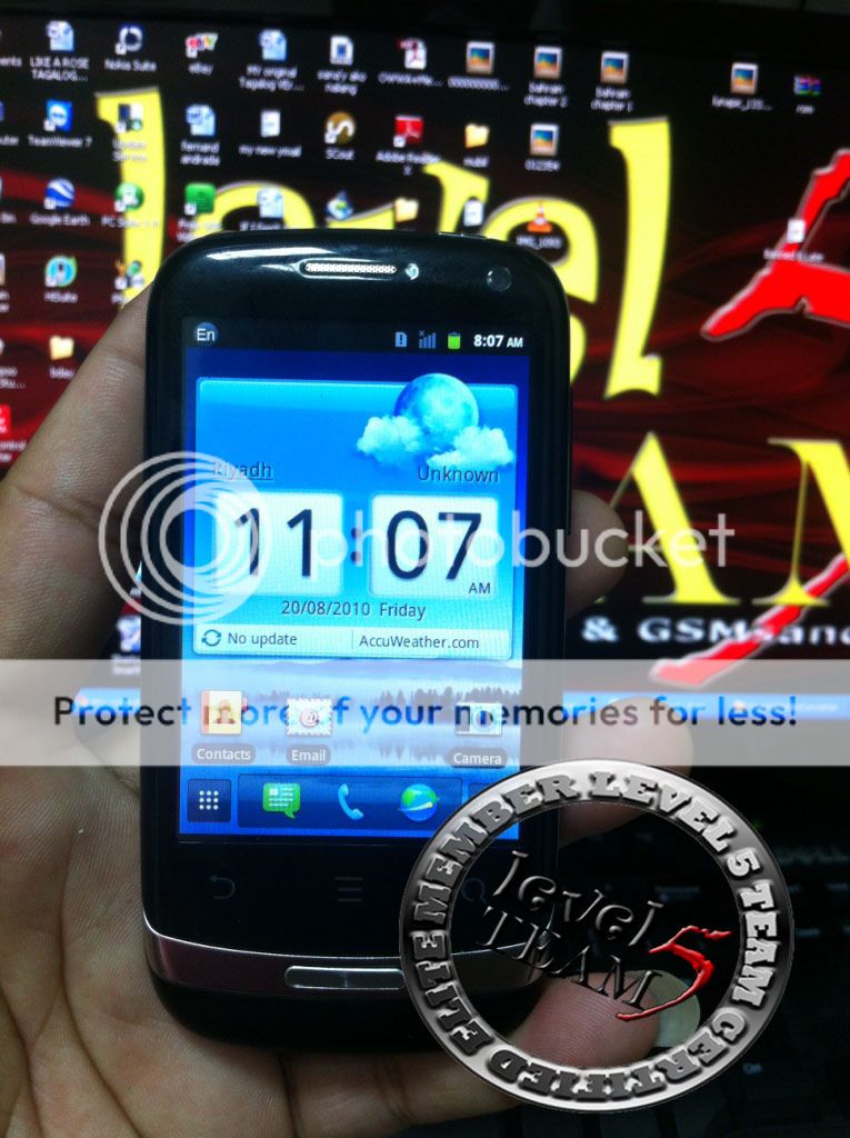

Status of unit
[ame=http://www.youtube.com/watch?v=xd8Gcdbseqk&list=HL1339417085&feature=mh_lolz]Fertxter x3 u8510 - YouTube[/ame]

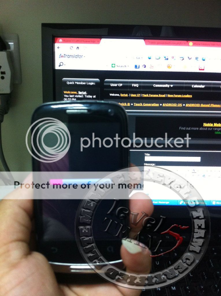

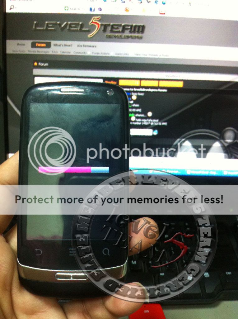

Procedure
1) Download ROM Fertxter
2) BIG Notes Format your SD card in FAT32(NO NEED TO FORMATE IF ITS ALREADY FAT32)
3) create a folder "dload" off course without the quotes on to the root of your SD card.
4) Extract the UPDATE.APP from the stock ROM and place it in "dload"
5) Power off your phone with sd card inside.
6) Power on by pressing POWER+VOLUME UP+VOLUME DOWN Button if done properly you will see progress bar saying UPDATING! after its done it will reboot automatically and YOUR phone good as NEW!!!!!
Thanks for the view mga Pisot
