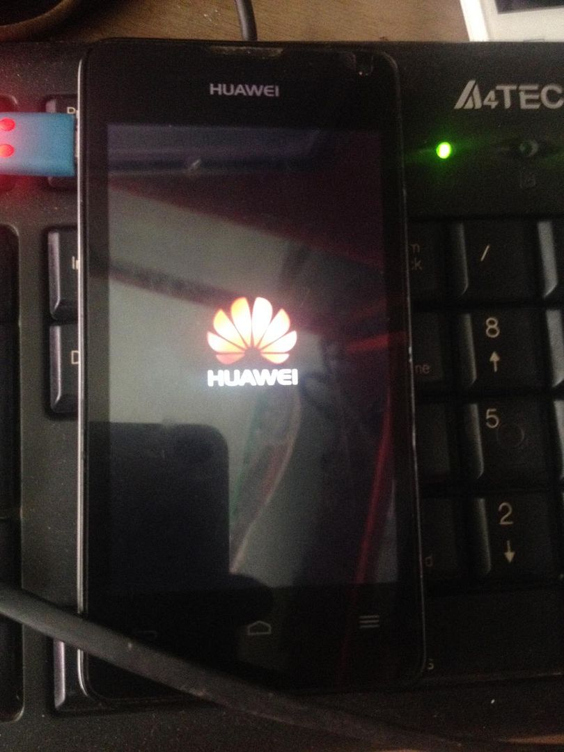

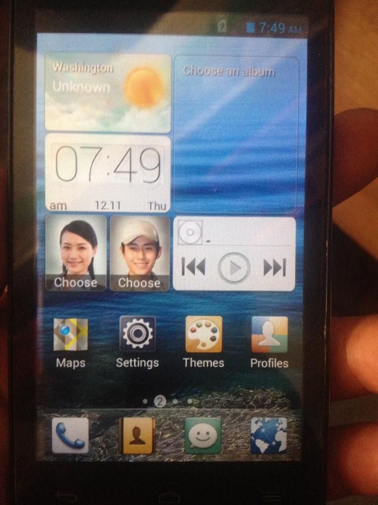

my tanggap po ako huawei y300 with power and tones w/o display
1st step baklas dahil matik na hardware na po
nasa ilalim ng simcard at memory card flex ung cpu at emmc
2nd steps mild reheat po ntin ung cpu at emmc ( posible na back job kaya inuga ko na po ung cpu)
d ko na po nakuhaan ng pictures ung pagbaklas kase nagmamadali yung customer
FINISH PRODUCT :
