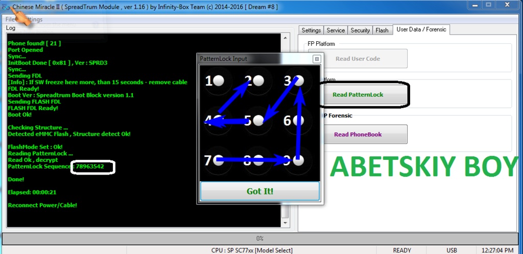

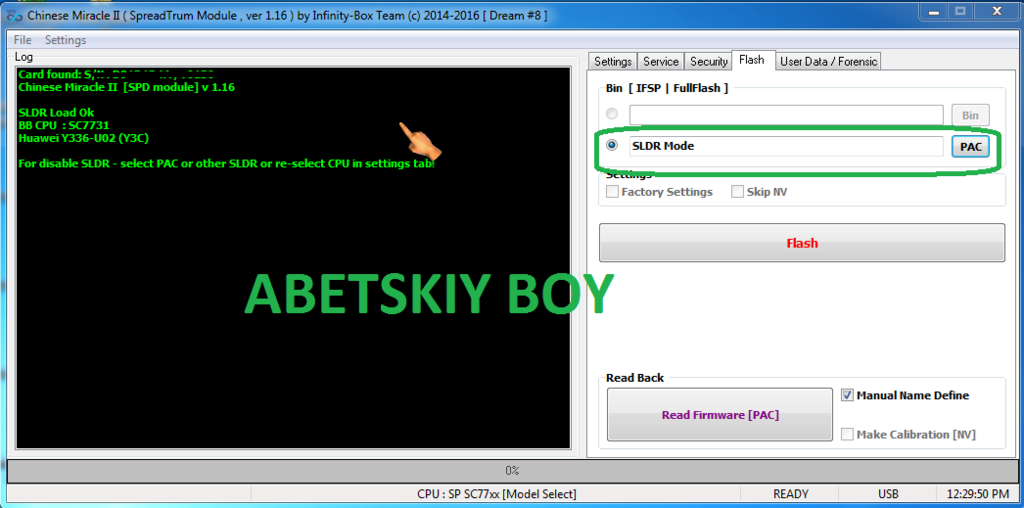

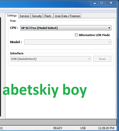

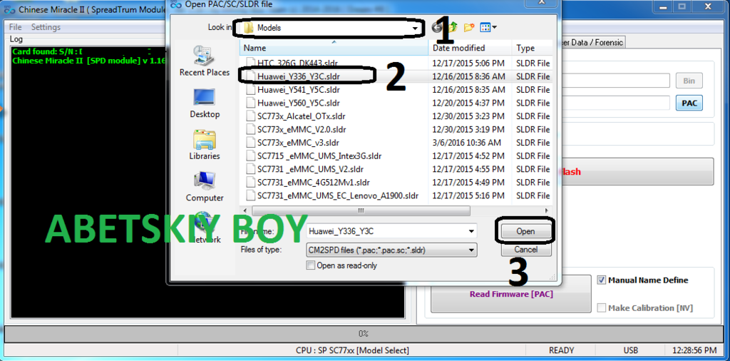

CLICK RUN CM2SPD SITTING SP SC77XX ( MODEL SELECT )
TAPOS CLICK NINYU PAC HANAPIN NINYU ANG SOPPORT NG CM2SPD FOLDER PAGKATAPOS CLICK ANG MODEL HANAPIN ULI ANG SOPPORT NG MODEL UNIT Huawei_Y336_Y3C.sldr
E READ ANG PATTERN NG UNIT
TAPOS NA ANG PROBLEMA N PACMAN PACQUIAO ALAM NINYU NA GAGAWIN MGA BOSS
SANA MAKATULONG PO SA INYU MGA BOSS
