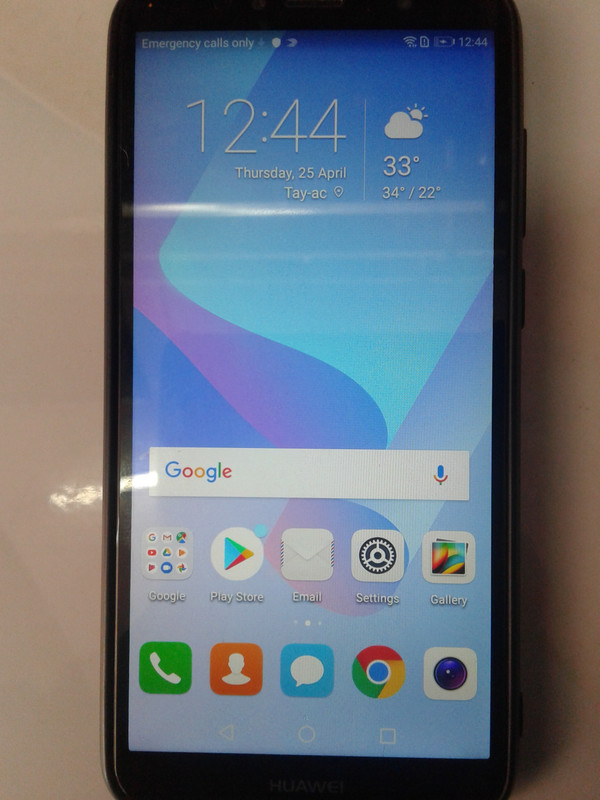

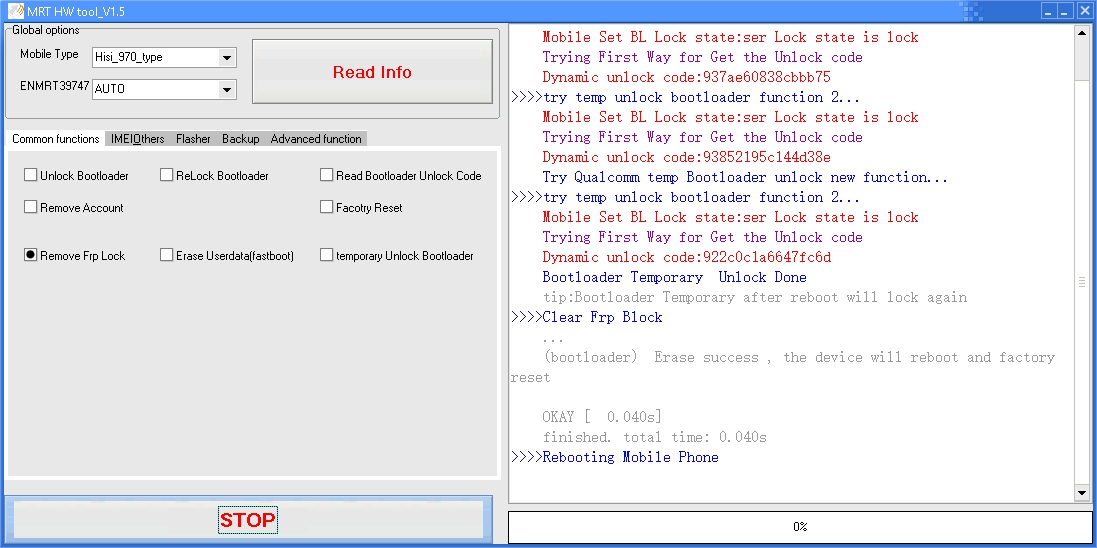

andreivi Expired Account Joined Jul 30, 2014 Messages 1,986 Reaction score 271 Points 381 Location Sison, Pangasinan/ Rosario, La Union May 28, 2019 #1 share lang mga Ka ANT Huawei Y6 (2018) ATU-L22 FRP Done sa sa mrt dongle ilagay yung unit sa fastboot mode (volume down tapos salpak usb) open nyo po MRT HW tool select mobile type hisi_970 select Remove frp lock sundan po yung nasa picture done na po
