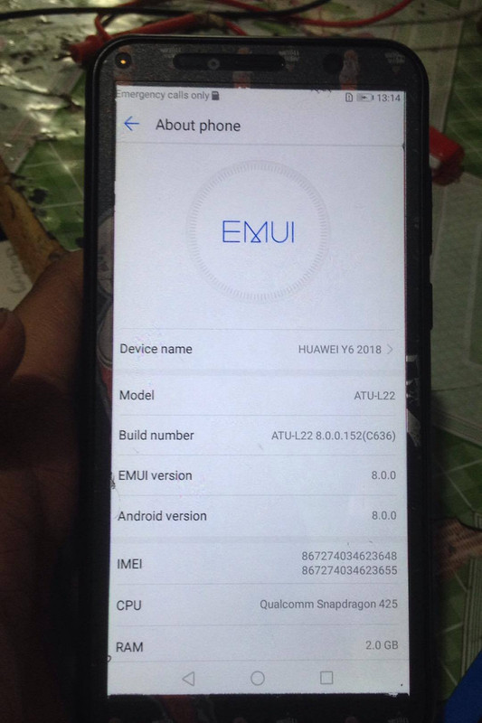

Huawei Y6 2018 ATU L22

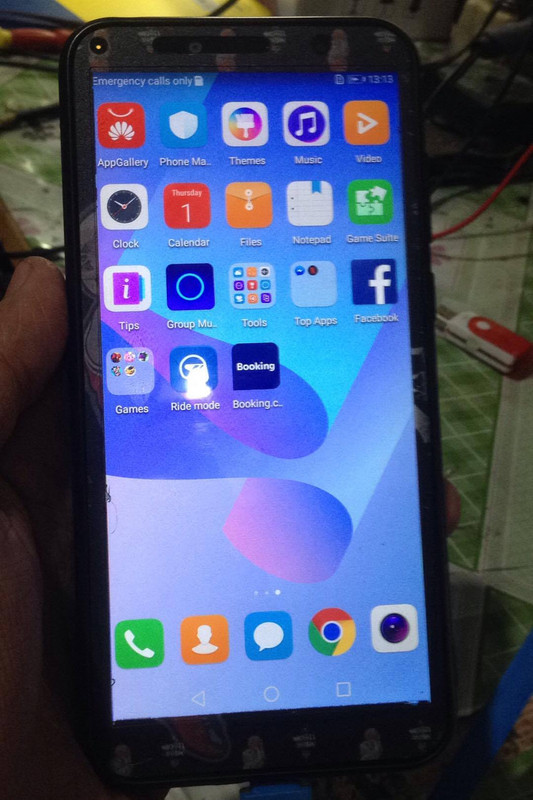

problem password nakalimutan
done by hard reset
alam ng ng mga tunay na tech procedure nian
kaso may frp

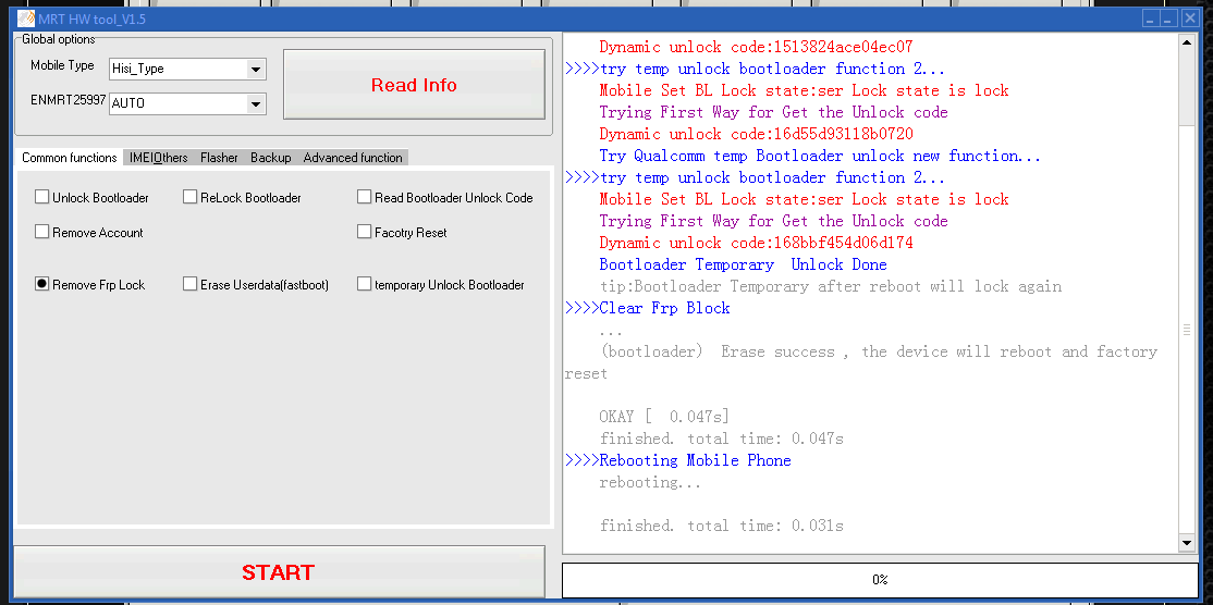

kaya open mrt dongle
isang salang lang
procedure
open mrt software
select hw tool
tick remove frp

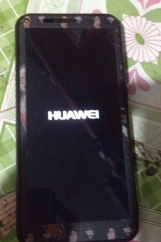

put phone in fastboot mode
hold volume down ang power then
insert usb
wait to install driver
then start
wait until finish
