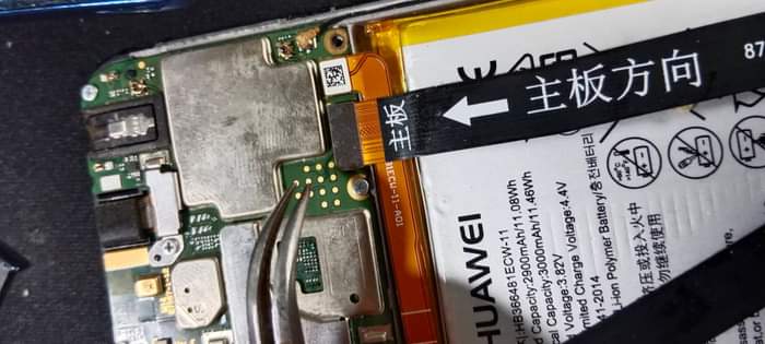

huawei y6 2018
baklas unit
frp problim test point

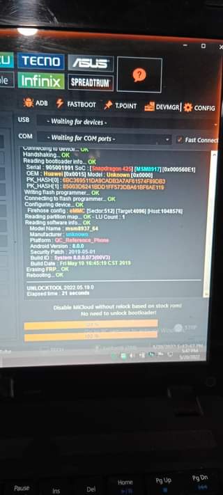

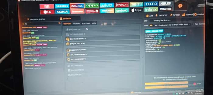

1 opin unlock tools
2 select huawei tab
3 click huawei y6 2018
4 test point

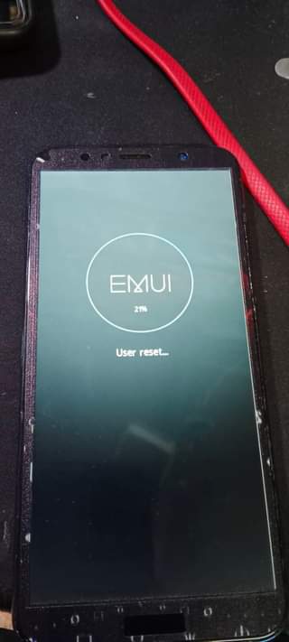

5 click erase frp
6 waiting done
