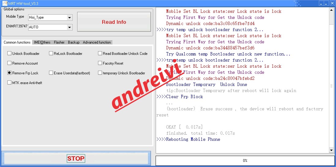

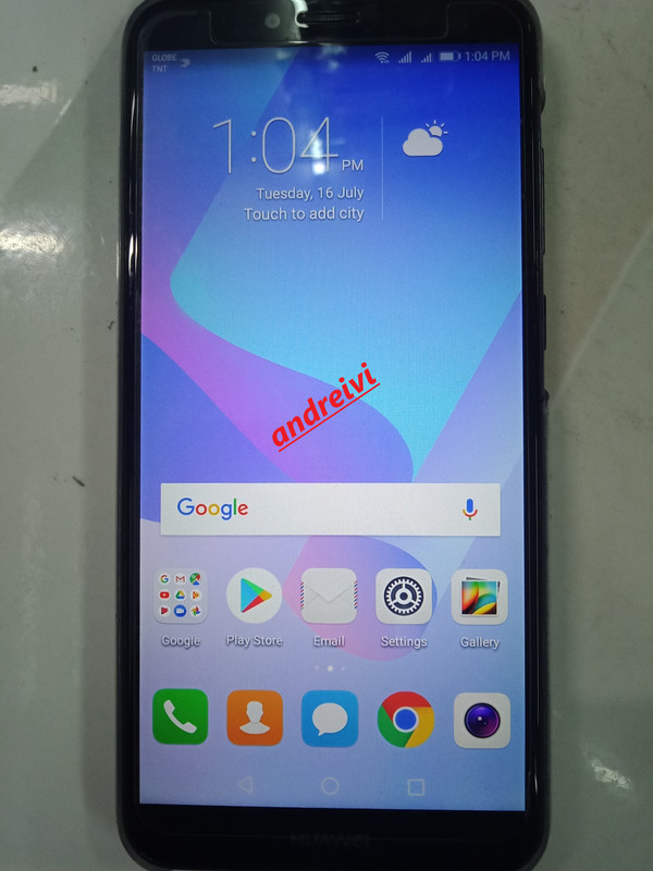

Huawei Y6 (2018) password and frp done sa MRT 3.15

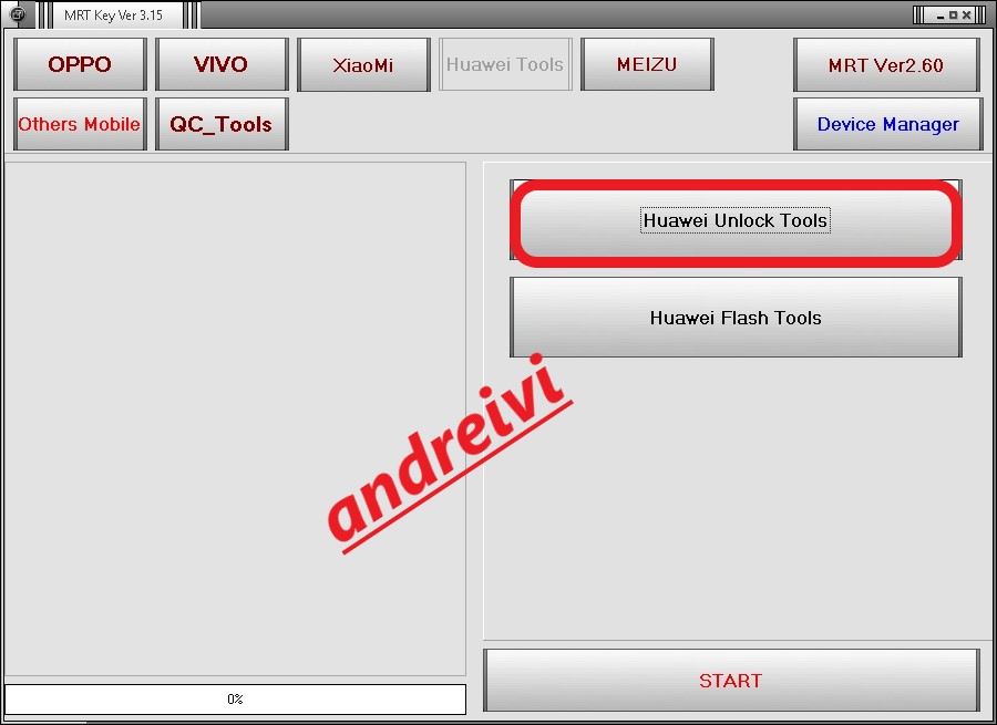

MRT 3.15 ginamit ko kasi hindi tumutuloy sa version 2.60
turn off unit
Hold VOL- & connect usb (for Fastboot)
open po yung MRT 3.15
select huawei unlock tools
pag nag open na yung MRT HWtool
select Remove frp lock
then click start
antayin matapos
done na po yung unit
