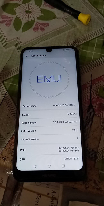

samzhen_23
share ko lang po
HUAWEI Y6 PRO 2019 PASSWORD FRP DONE

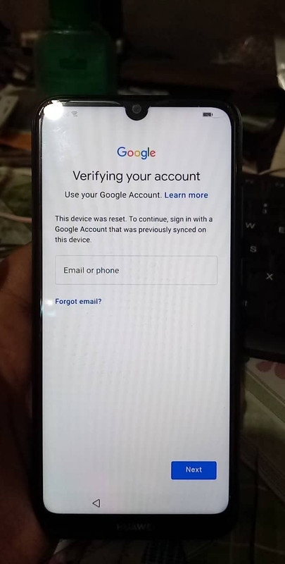

yan may frp

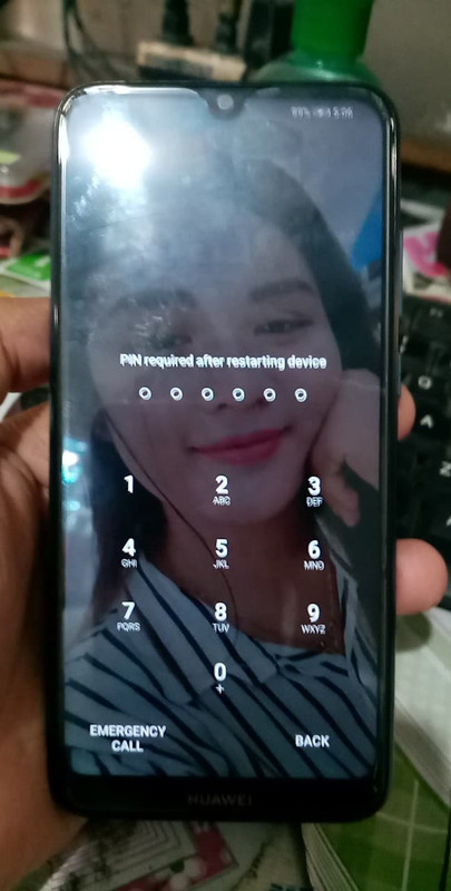

go to ssecurity & privacy
add lang kayu ng lock screen password
then restart
then balik sa umpisa next
add wifi next
then use lock screen password instead of google account

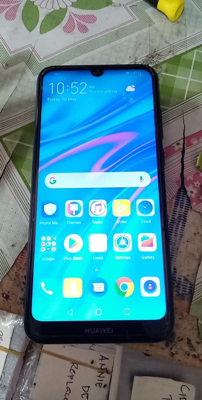

enter nio lang pass na nilagay nio then boom wala na google account
sana makatulong sa mga nangangapa pa katulad ko thanks for viewing
