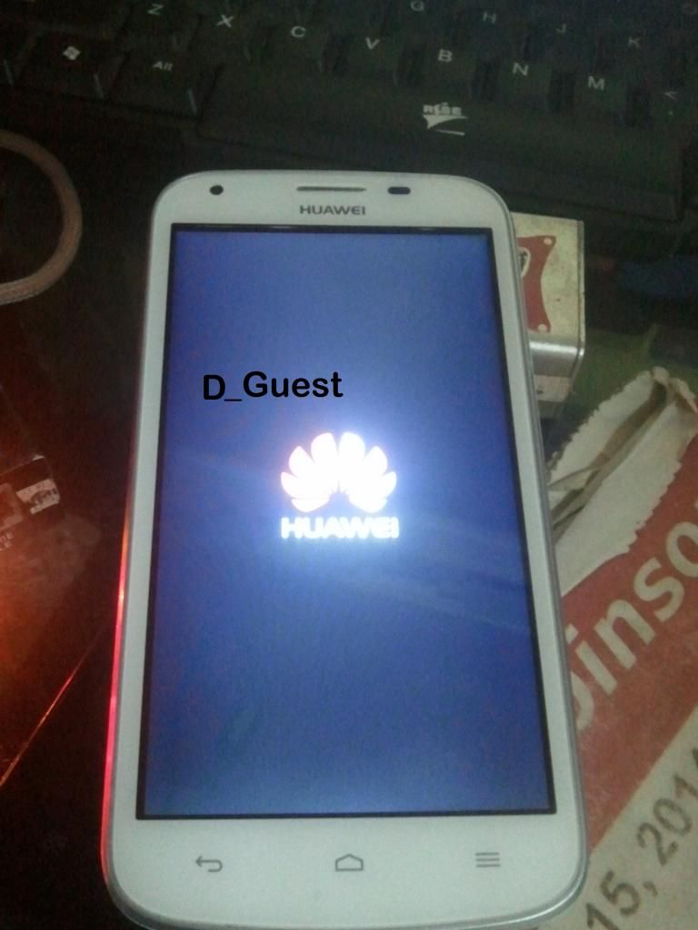

Unit/Model: Huawei Y600-U20
Problem: Hang On Huawei Logo

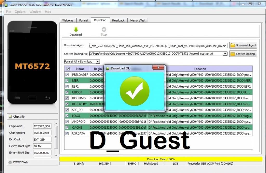

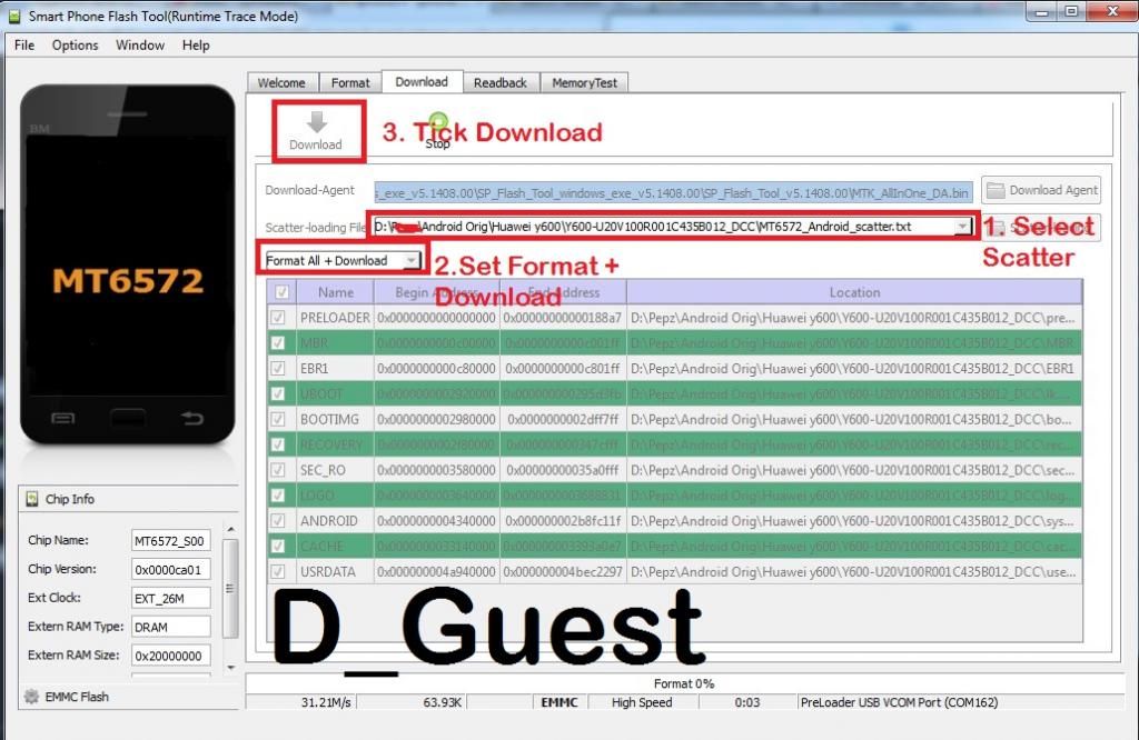

Action Taken: 1st Hard Reset No Luck, 2nd Option Program using SpTool
tick Scatter loading and select scatter file
choose set format + download, default is download only
the tick download,
reconnect battery from phone then insert usb
see screenshot below:

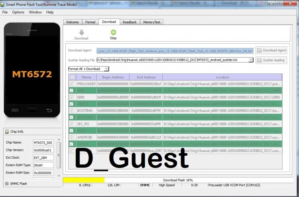

wait for process to be done

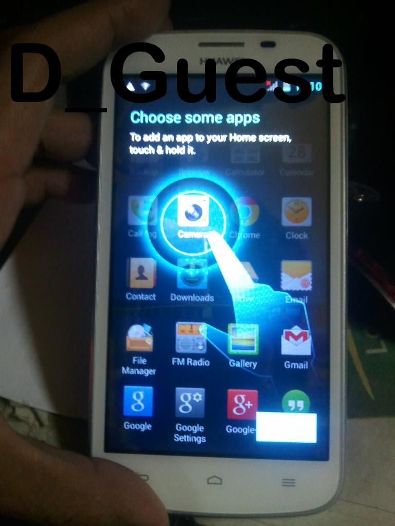

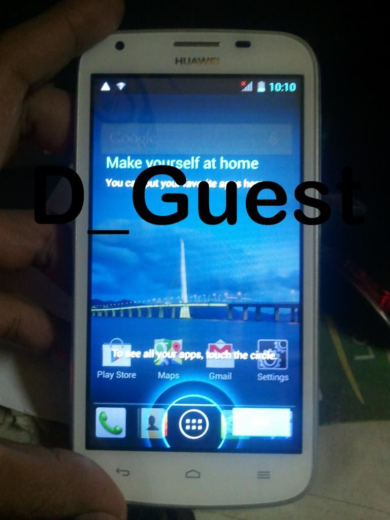

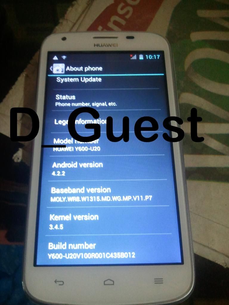

Finish Product:
all working fine,

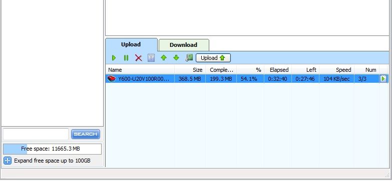

Firmware and Flashtool currently uploading
I will update this thread as long as I finished my upload wait wait po mga sir
