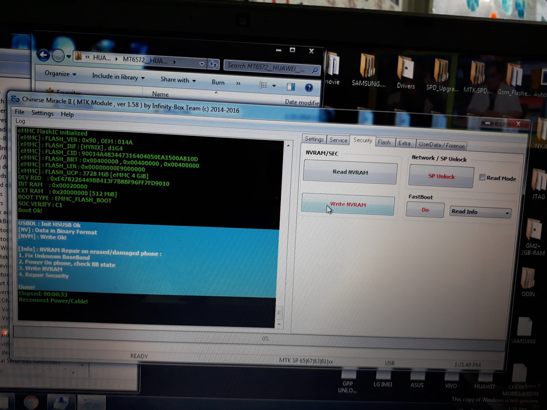

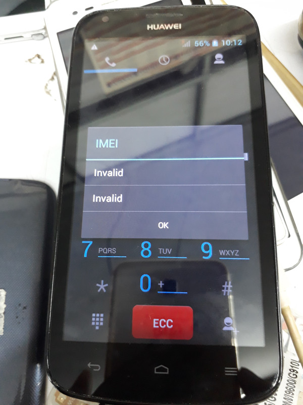

goodDAy mga ka antect share ko lang invalid/unkknown IMEI y600-u20
done sa CM2 dongle
open CM2dongle MTKmodule
click SECURITY and WRITE NVRAM
hold volume up+ and down- button
wait in seconds write IMEI
firmware here DL..

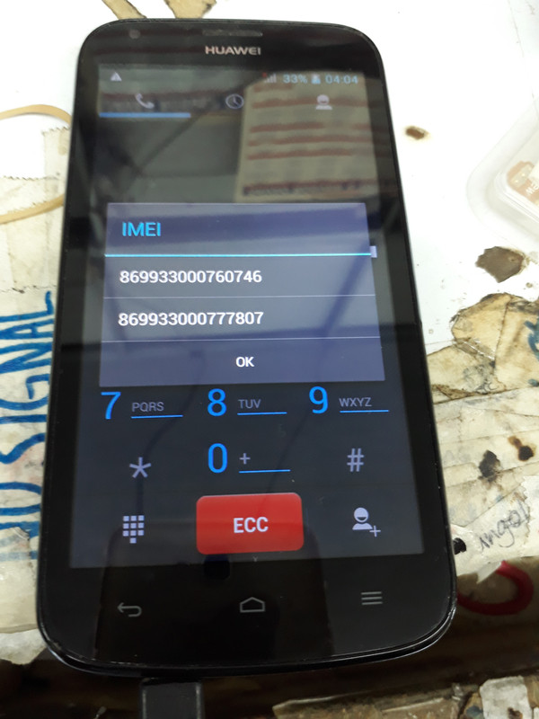

done ...sana makatulong sa tahanan..
