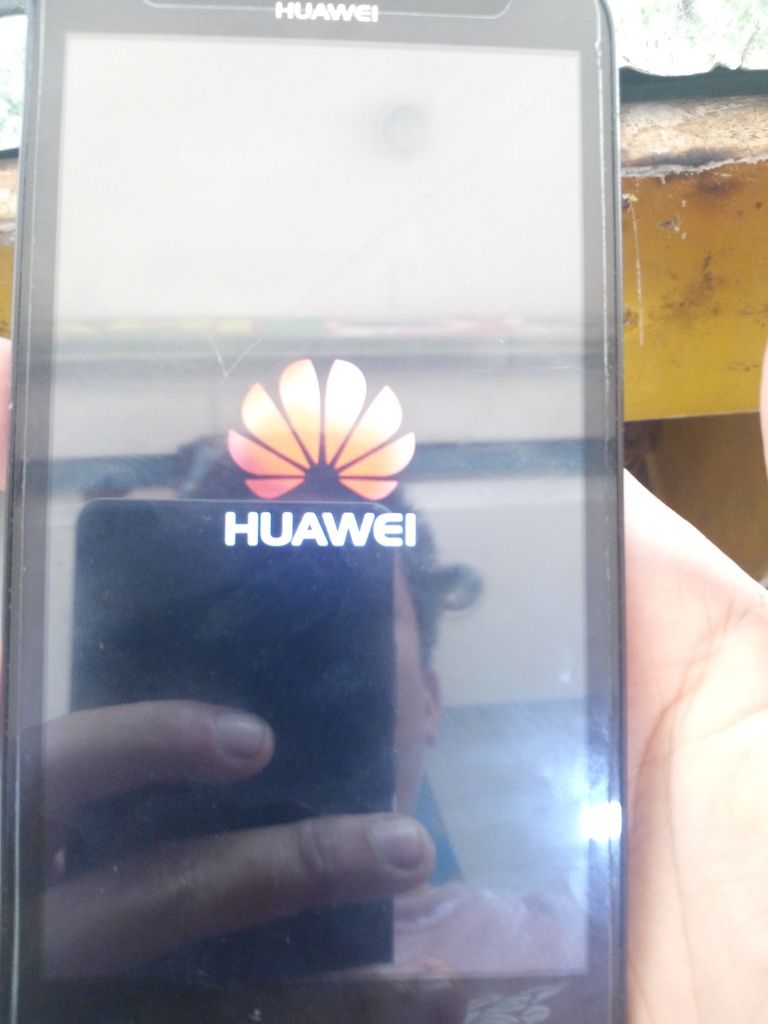

Problem: hang sa Logo
Action taken: No luck sa hard reset din hanap firmware buti nalang nakita ko post ni boss gemma

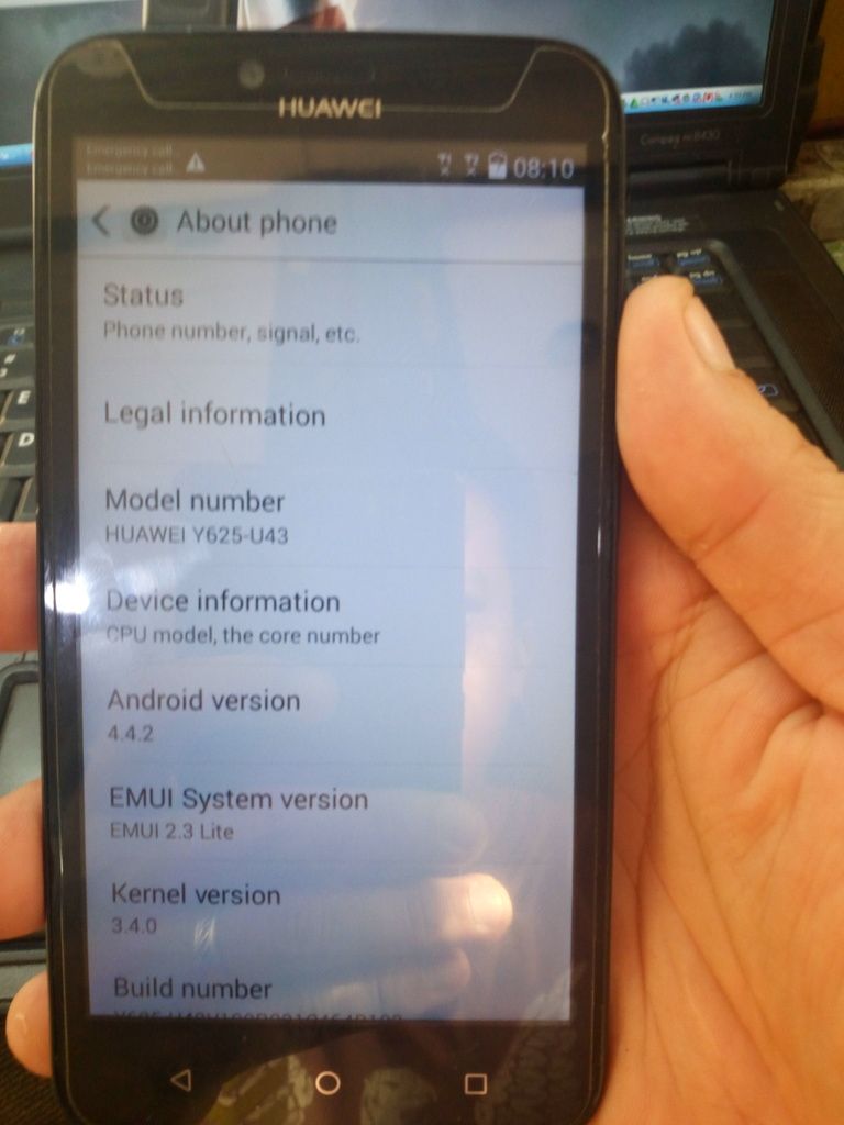

gamit ko colombia
100%tested

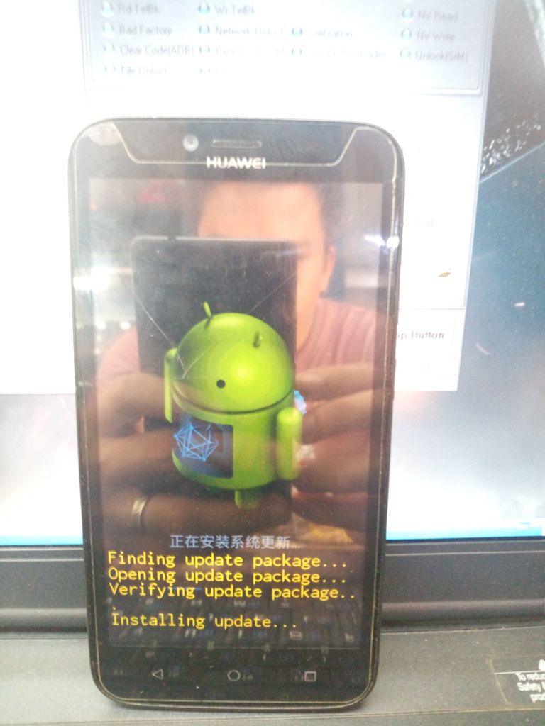

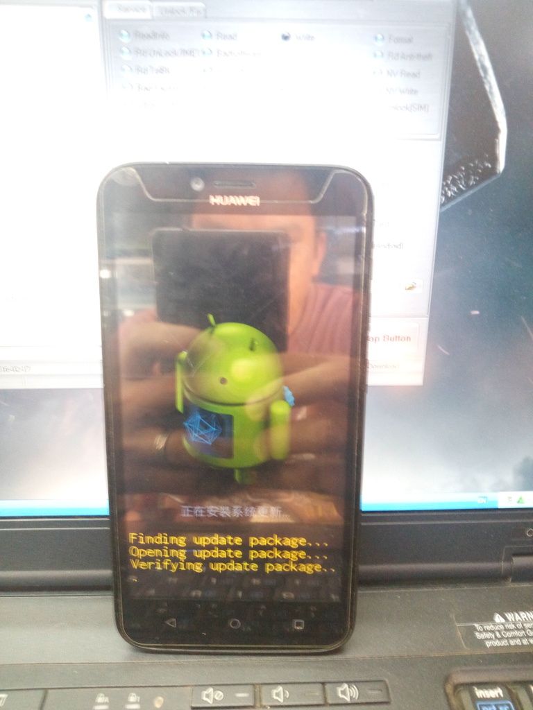

Procedure:
extract files copy dload folder to sdcard
hold vol. up vol down & power

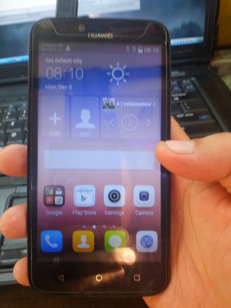

then release kung lumabas na ang firmware update
wait until finish!!
