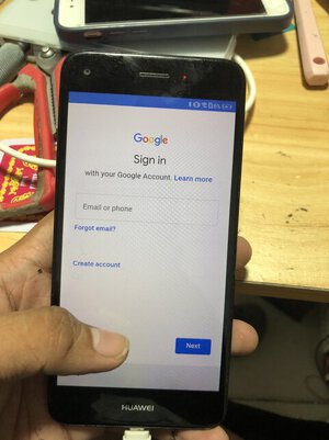

Share lang po mga boss huawei y6p 2017 frp. Sobramg kunat sa manual.

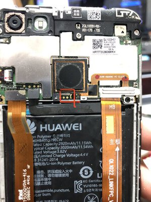

Kaya proceed nako sa hydra dongle bali test point po ito

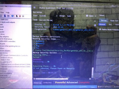

Open Hydra Tool
Select Qualcomm
Select Brand: Huawei
Select Model: Sla-L02 bali p9 lite po nalabas sa model pero sa pc detected po as Y6p 2017
Select Universal
click Factory Reset Protection
ClIck Execute
Reminder: Naka salpak po battery nung mag TP ako.
