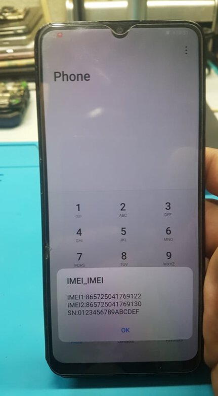

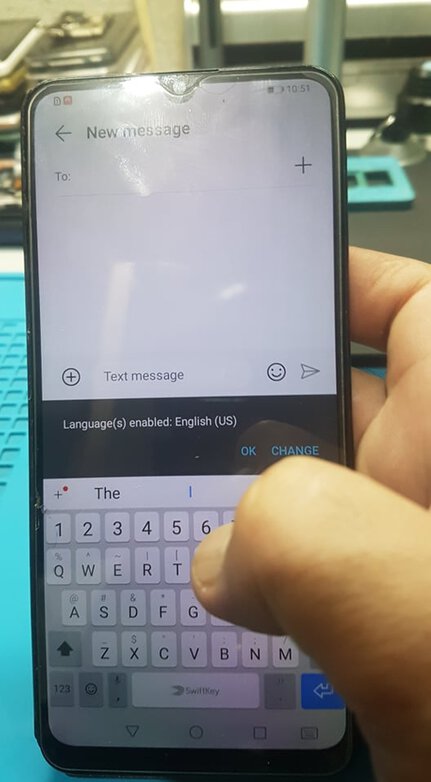

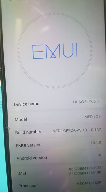

Procedure:
first download the files we need_https://www.4shared.com/account/home.jsp#dir=DVbrYVi7

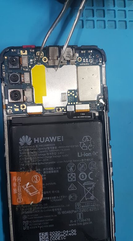

disassemble phone to perform the edl mode

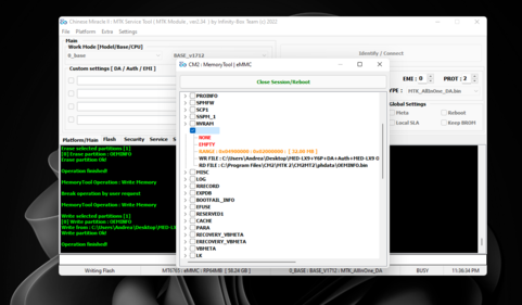

open CM2MT2 go to extra tick memory tool then tick init device perform the edl mode phone should be detected
browse oeminfo then erase, after that browse again the oeninfo then write using the files we download
then reboot phone
OEMINFO writing done
thanks po
