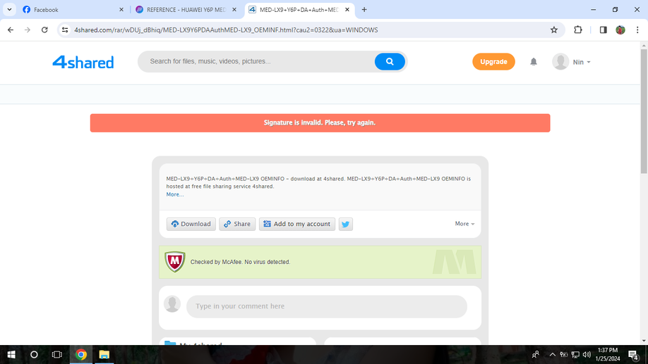

Then download this OEMINFO.BIN https://www.4shared.com/rar/wDUj_dBhiq/MED-LX9Y6PDAAuthMED-LX9_OEMINF.html (Credit pala sa Original uploader ng file Thanks.)
