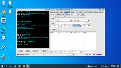

ISA NA NAMANG KAPAKIPAKINABANG NA TOOL TO SA MGA GUSTO NG CRACK
SANA MAKATULONG SA TAHANAN NATIN...
DOWNLOAD HALABTOOL: https://mega.nz/file/87xABCaA#e9oz1KafeZvTGZX9ZeqYpw6_BCJdeKB_4yLfEsfzcOk
INSTAL HALABTOOL

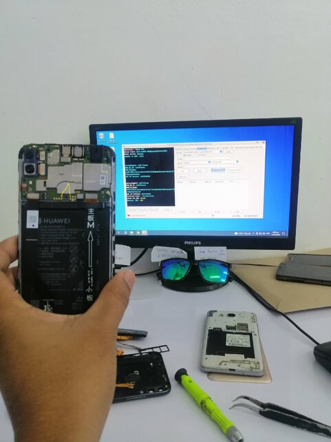

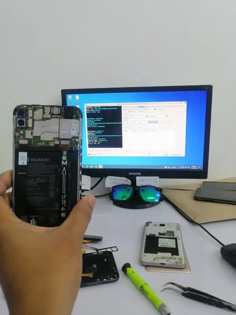

OPEN HALABTOOL, TAPOS CLICK QUALCOM, SELECT MODEL TO HUAWIE Y7 PRIME 2019
check driver port if connected na sa halabtool, tp mo yan bossing para ma detect, nasa pic yung guide sa tp.
CLICK REMOVE FRP TO START THE BYPASS..
note: dapat testpoint po mga idol para detect yung unit mona sa halabtool
pag nag remove frp completed, tapois na po yan.
