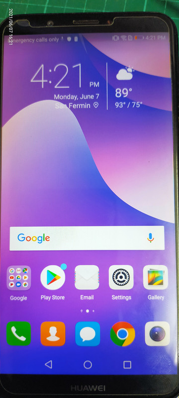

PASSWORD & FRP VIA TESTPOINT IN ONE CLICK DONE!

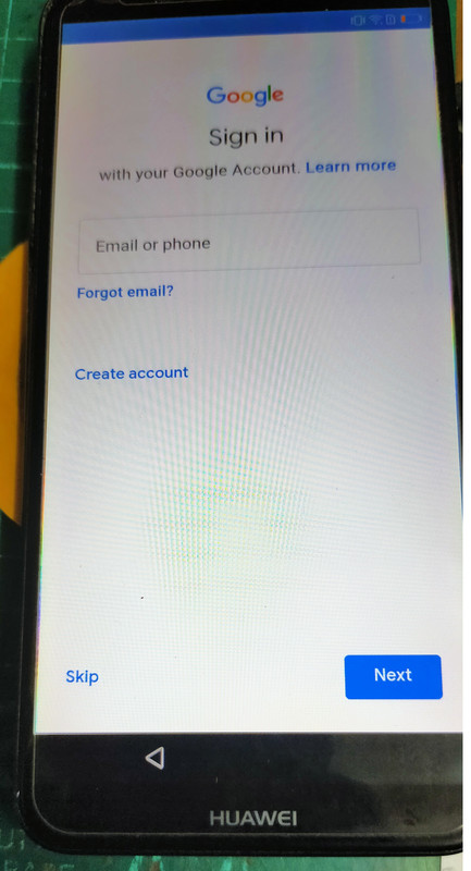

PROBLEM: nakalimutan ng may ari na hard reset nya via youtube daw

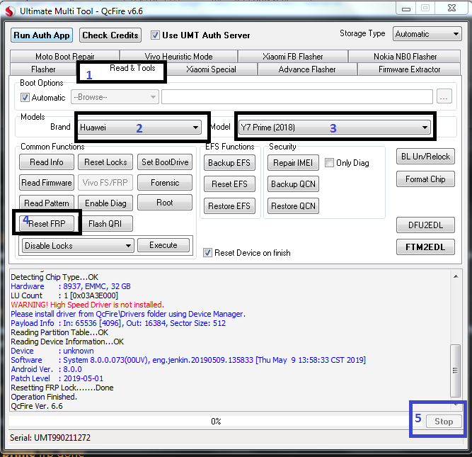

Open Qc Fire V6.6
click lang ito "Read and Tools, select brand, select model then tick Reset frp

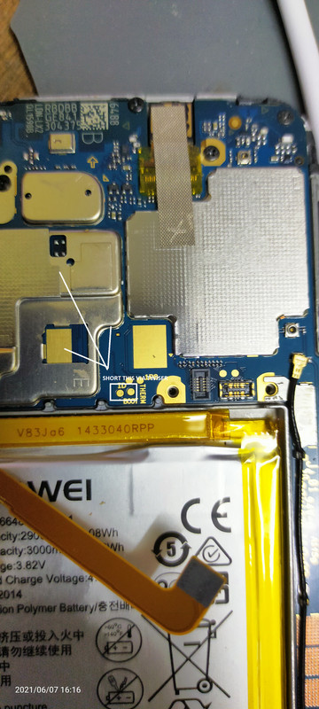

Open back case tapus tanggal lang mo un batt. then short this, tapus wait mo nlng matapus done na
