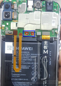

So eto ginawa ko. . hanap test point. . Sa Google. .

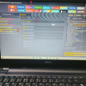

*Buksan si Unlocktool
*Pindot Huawei TAB
*Hanapin si HUAWEI Y7 PRO
(DUB-lx3) and select
*Click SI remove FRP
*iTest Point na SI unit
*Sundot SI USB
Antayin matapos at. Tanan. . Smile na sana makatulong. .
