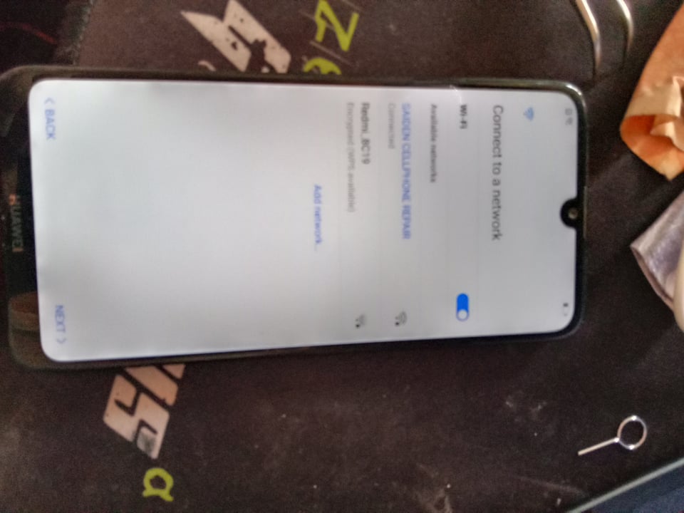

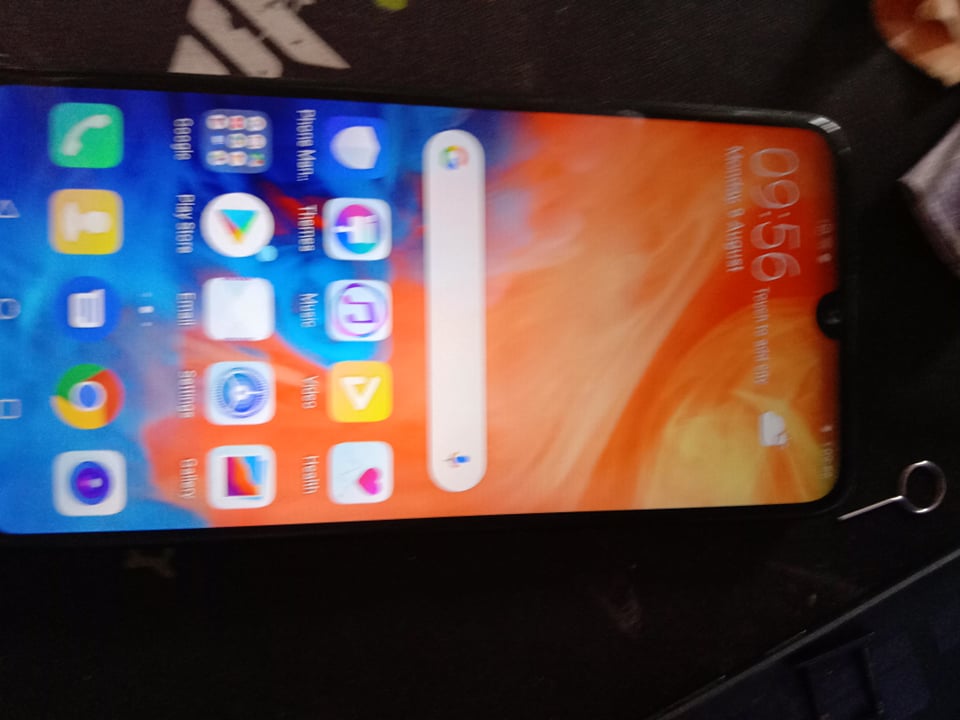

share kolang mga boss

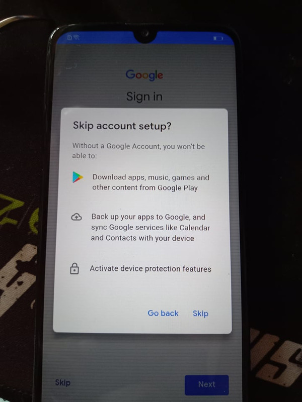

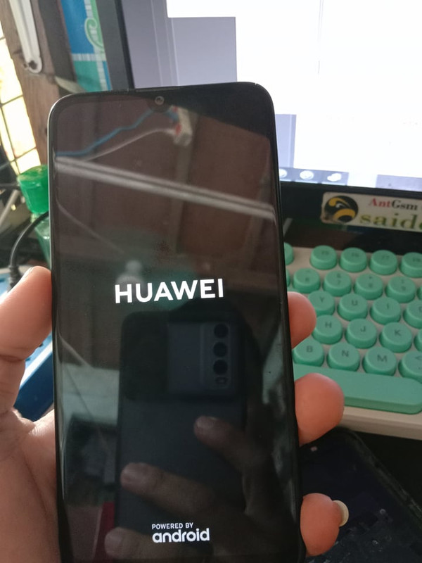

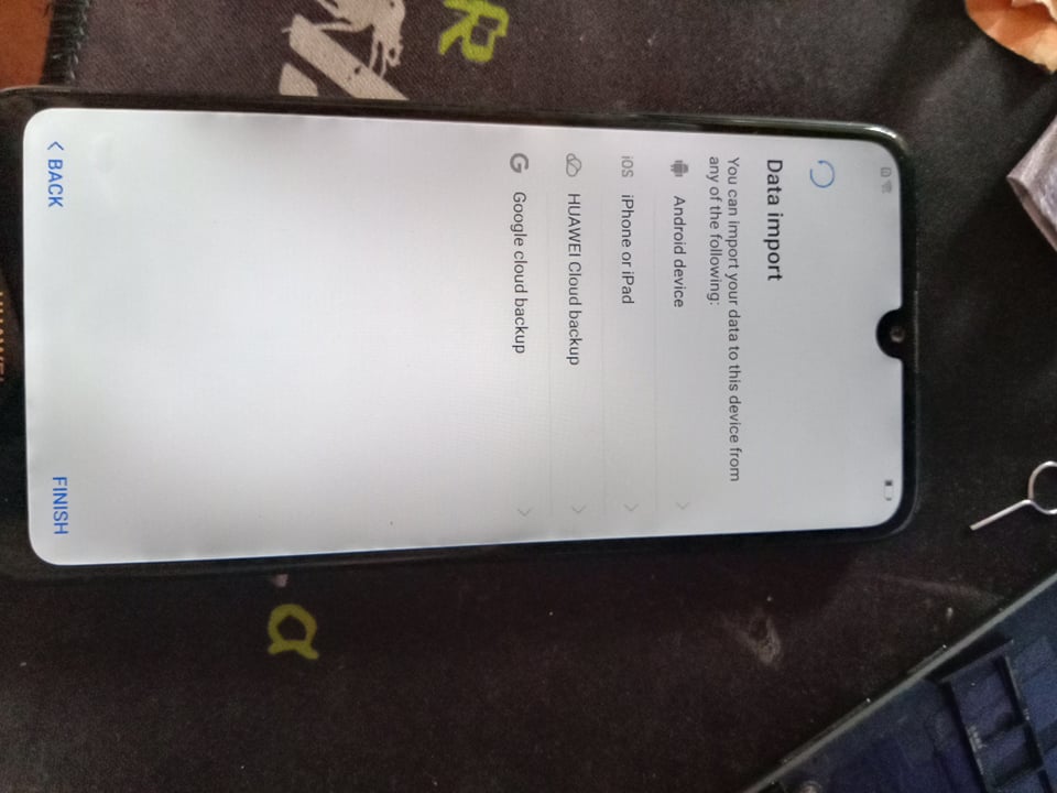

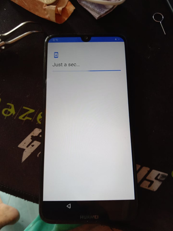

tangap ko y7pro 2019
nereset ng mai ari
nag karuon daw ng google account
ayaw tangapin daw unG
ginawa nyang google account
PROCEDUCE
NEED BAKLAS UNIT
TP

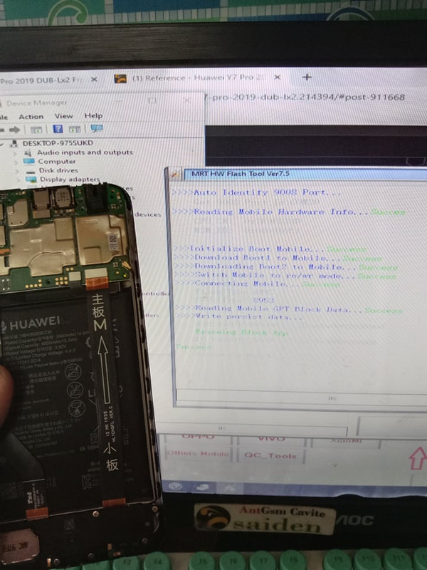

OPIN MRT,3,81
CLICK/HUAWEI FLASH TOOLS
CLICK /UNLOCK ACCOUNT
CLICK/ ERASE ACCOUNT

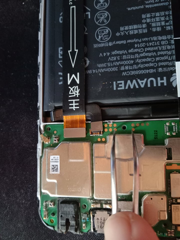

TANGAL ANG BATTERY
THEN TP SALPAK USB CABLE
PAG NABASA START WAITING
DONE

BAKA MAKATOLONG
