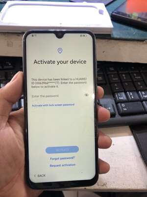

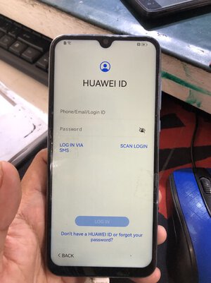

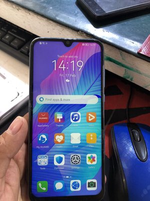

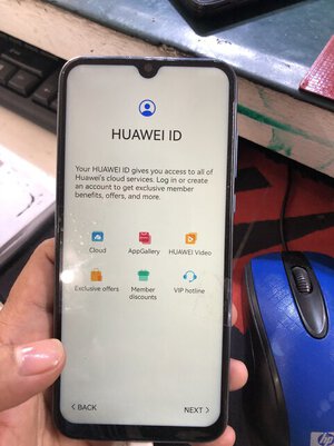

HUAWEI Y8P AQM-LX1
ISSUE: HUAWEI ID LOCK

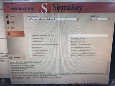

TOOL: SIGMAKEY BOX
SOFTWARE TOOL: SIGMAKEY APPLICATION
PROCEDURE:
open sigmakey application
select plattform HISILICO
HISILICON TAB KIRIN710

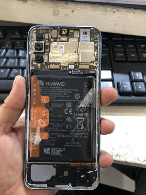

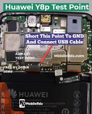

testpoint unit
serial port huwei com.1
service tab the click remove huawei id

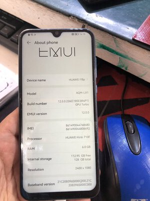

wait unti finish done..
smile kana..
