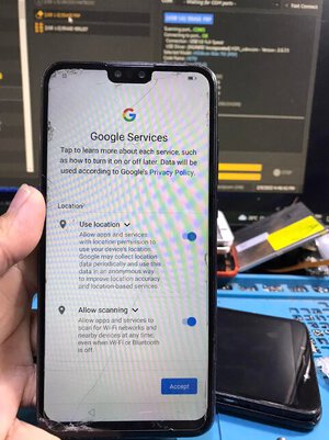

suki dala y9 2019 password forgot ok maam balik na lng 30 mins

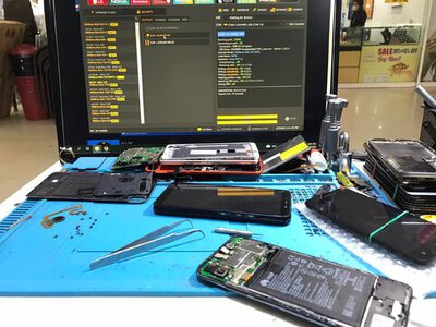

325627711_646295780677369_4153419871143343336_n.jpg326200574_952863809421555_7438800032041257614_n.jpg326557185_729244608642119_6340701431735769240_n.jpg326389621_884318042713705_102638325103201062_n.jpg325478168_1652903745170446_6706131050759343076_n.jpgprocedures mga pitechs

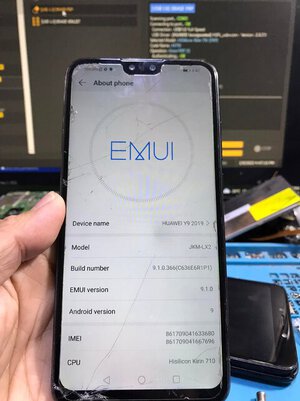

after hard reset

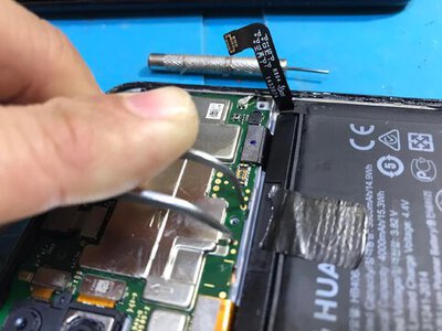

open unit back case for TP

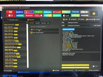

open unlocktool
select huawei
select kirin 710 FRP
select ERASE FRP
din TP + Connect USB
wait done
