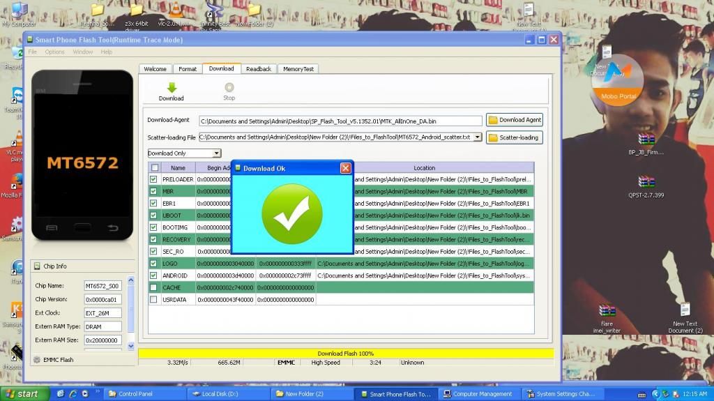

Nag download lang ng apps
si tumer biglang nag off
at nag hang nalang
- Unit : Huawie Y511-U30
- Prob : Hang on Huawie logo only
Firmware&tools CLICKME
- Procedure
- Open SP Flash tools
- Tick Scaterd and Brows U30 Scatterd Firmware
- Then Tick Download
- (Note) Flash W\out Battery
Done
Pasensya walang Finish Product naka limotan ko cellphone
ko sa bahay walang pang Capture pero 100000000000% tested firmware po yan.
Salamat And God bless all
