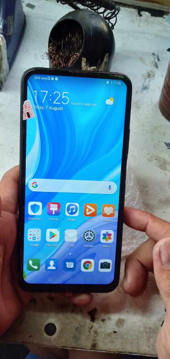

HARD RESET para sa password,,,,,,
FRP part,,,,,,,,,,,,,,,,,,,,,,,,,,,

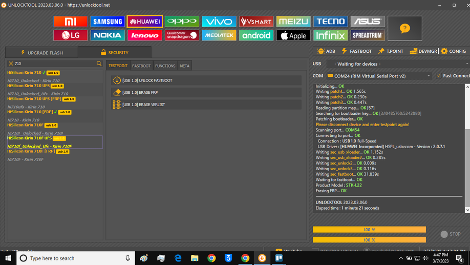

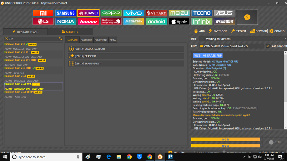

1, Baklas unit
2. Open Unloctool ,,, Huawie select
3, Seclect HiSilicon Kirin 710F UFS usb1.0

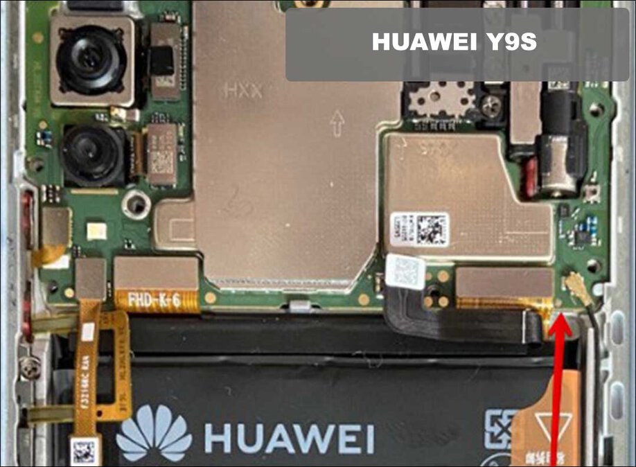

4, TP with battery , jung detect na USB1.0.. note 2 times tp ito gawin. Sundan lng ung instruction na lalabas para 2nd tp....
5, Hintay lang tagal sa fastboot install,,,
