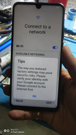

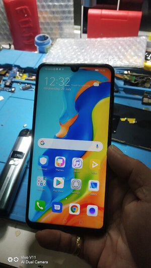

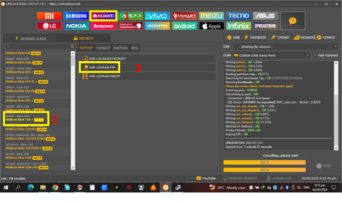

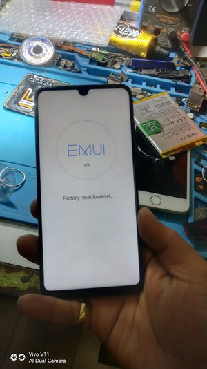

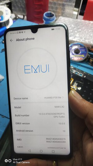

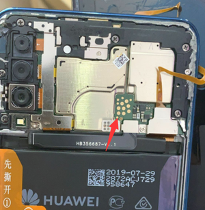

activa2r Administrator Staff member Joined Oct 30, 2022 Messages 714 Reaction score 2,652 Points 241 Location Leganes , Iloilo Feb 2, 2023 #1 Nag reset ang owner para mabura lahat.. Status ng unit.. Procedure: 1. Disassemble phone 2. Remove Battery 3. Connect Testpoint to Ground.. 4. Follow Picture in Unlocktool.. Finish.. For reference lang po mga boss..
dondan Registered Joined Nov 17, 2022 Messages 22 Reaction score 17 Points 1 Location batangas city Feb 28, 2023 #2 boss kailangan walang battery bago mo ikonek sa pc or laptop ?
J j4m2_6 Registered Joined Apr 27, 2021 Messages 1,435 Reaction score 2,961 Points 341 Location La Union ™️ ( Region 1 ) Feb 28, 2023 #3 dondan said: boss kailangan walang battery bago mo ikonek sa pc or laptop ? Click to expand... sir read -> 2. Remove Battery
