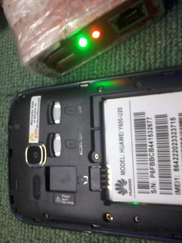

Run sigma key GUI
Select MTK flatform
Turn off phone or re insert battery

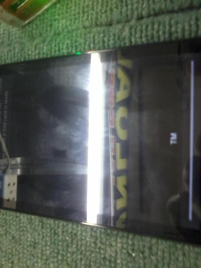

Connect phone to usb wait Phone hangs up in huawei logo

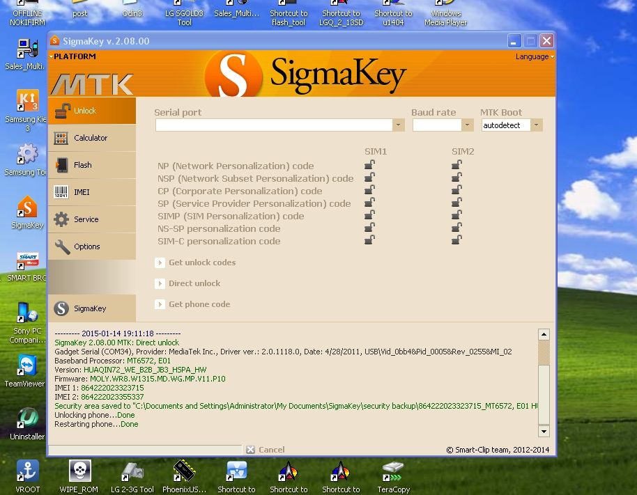

Install drivers if necessary needed
Select port android gadget vcom driver in port selection tab
Hit direct unlock and wait unlocking complete
done...
