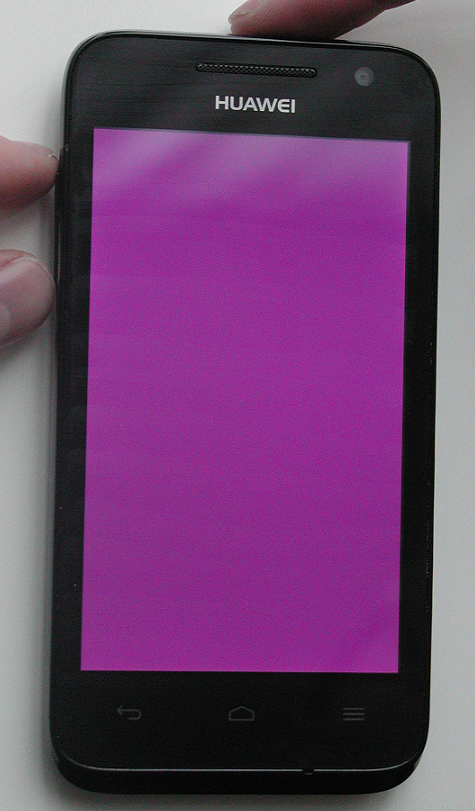

2. Turn off phone. Press "Volume down", "Volume up" and "Power" buttons. Hold them pressed for 5 seconds. Phone screen should become purple/pink. Connect phone to computer using USB cable

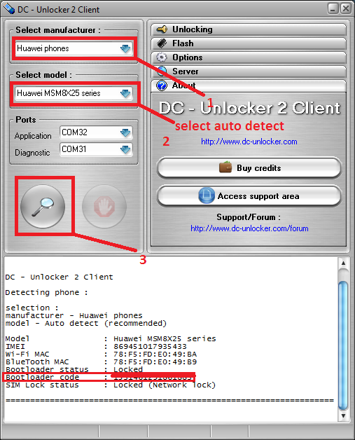

3. Launch DC-Unlocker client software select huwei phones/auto detect/search phone tapos save nyo lang ung bootloader coder gaya ng nasa picture
so may code kana para ma unlock ang boot loader

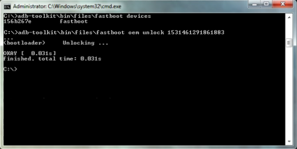

then open cmd type this command \adb-toolkit\bin\files\fastboot devices
if a message such as 156b267e fastboot is displayed, the connection is set up properly
Type in unlocking command - fastboot oem unlock password, for example, \adb-toolkit\bin\files\fastboot oem unlock 1531461291861883
ayus unlock na ang bootloader ng phone
To check bootloader's lock status simply repeat detection of the phone by DC-Unlocker or enter “fastboot oem get-bootinfo†in command window
