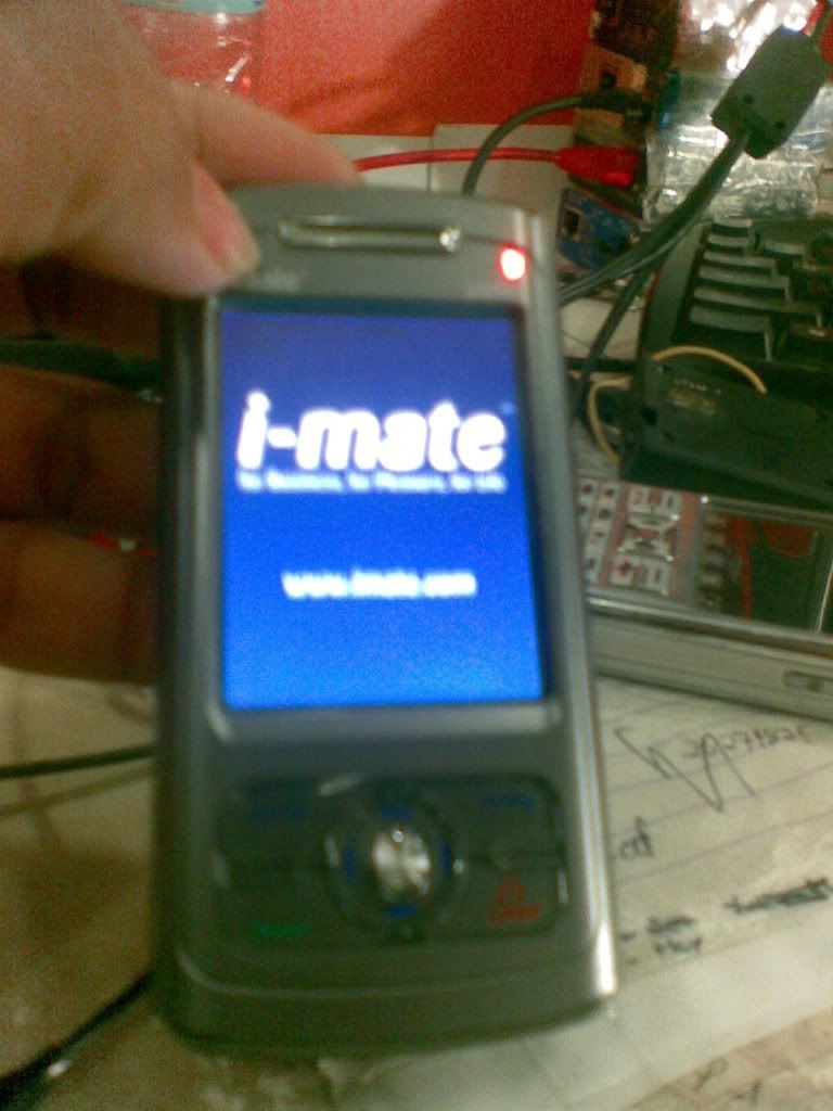

history:
bigla nalang
procedure:
press hold down volume switch+power button then connect battery
wait until it finish

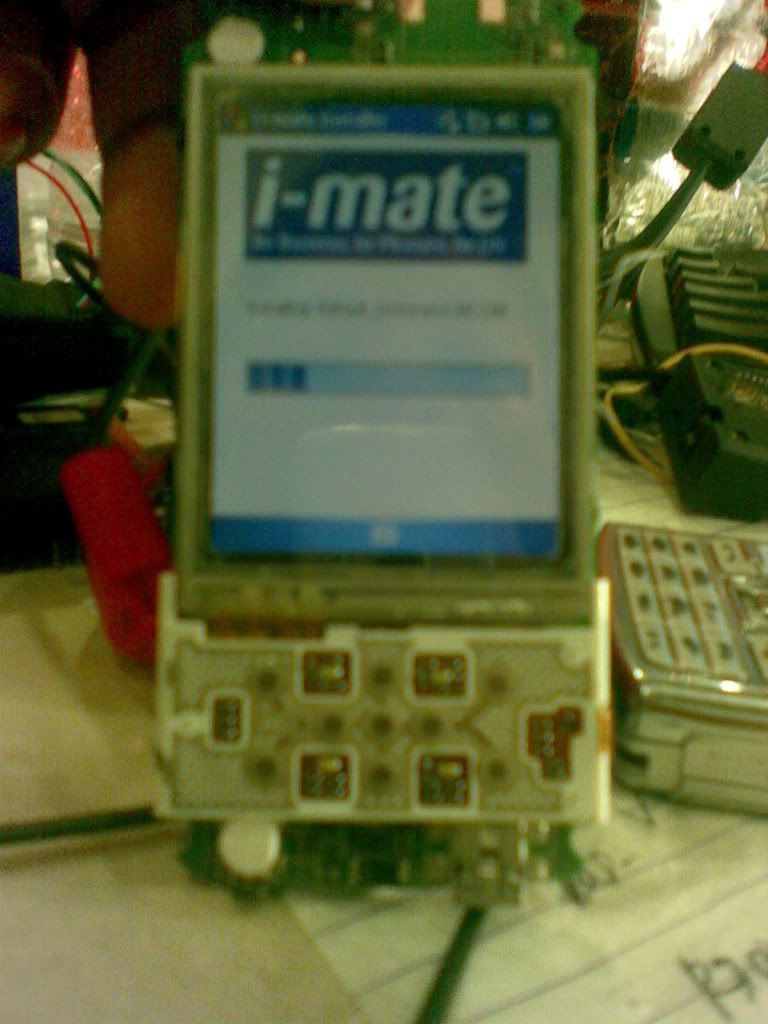

action taken:
hard reset using hold down volume + power on then connect battery
pero no luck at walang nangyari
kaya decide buksan sa ilalim..kaya pala walang efeck wala palang volume switch
kaya change volume switch tapos hold arrow volume + power on then connect battery
ilang seconds lang ayos meron nang efeck

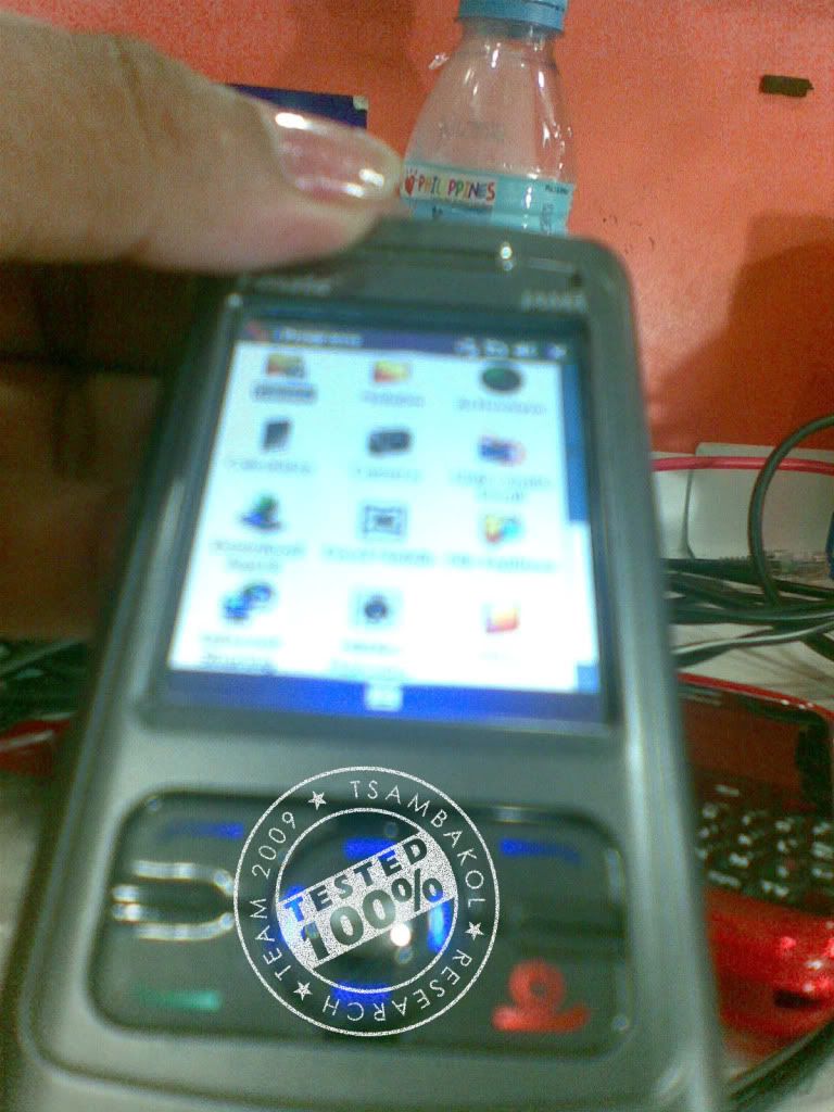

before:
after:
all done:
