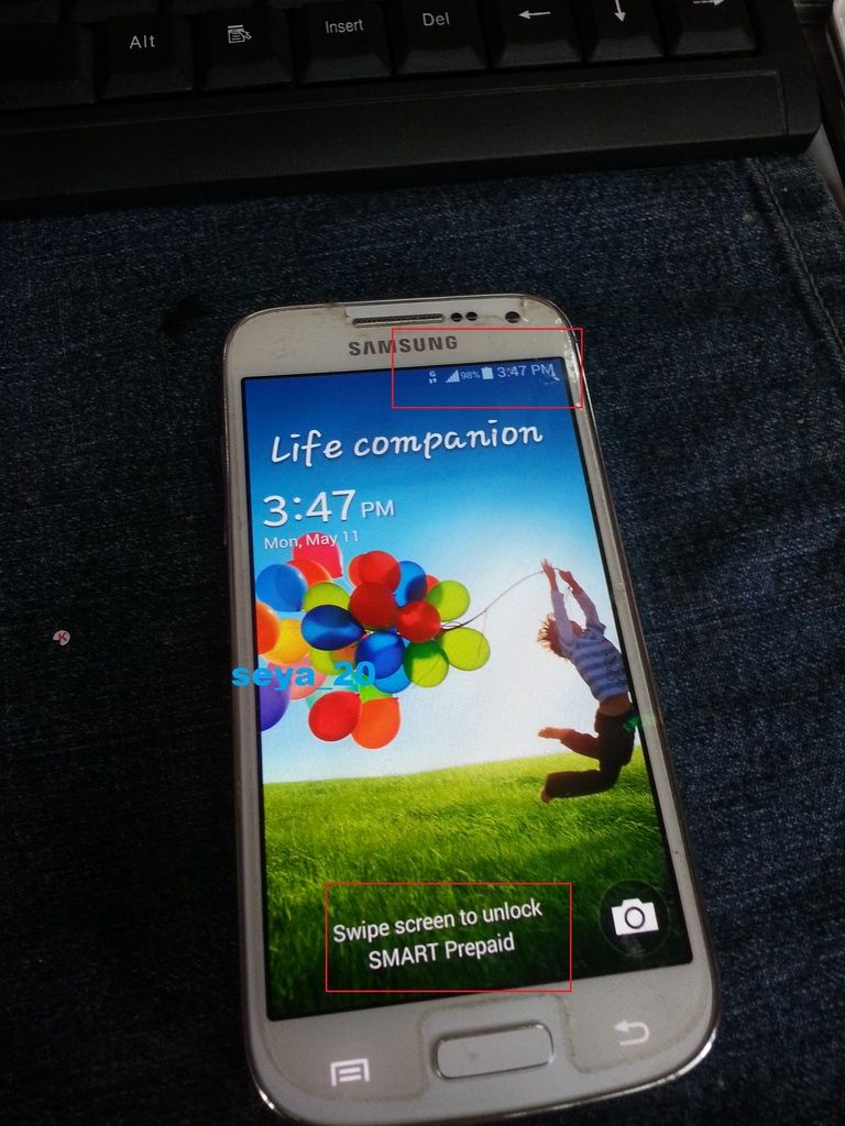

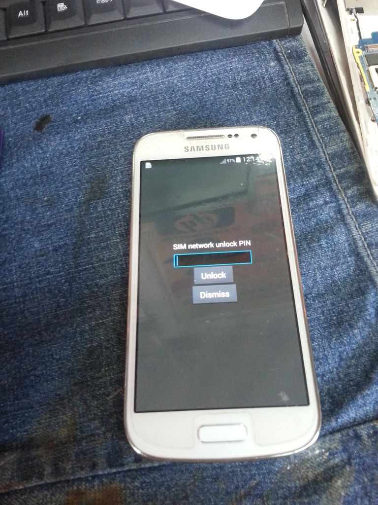

Carrier Locked in canada

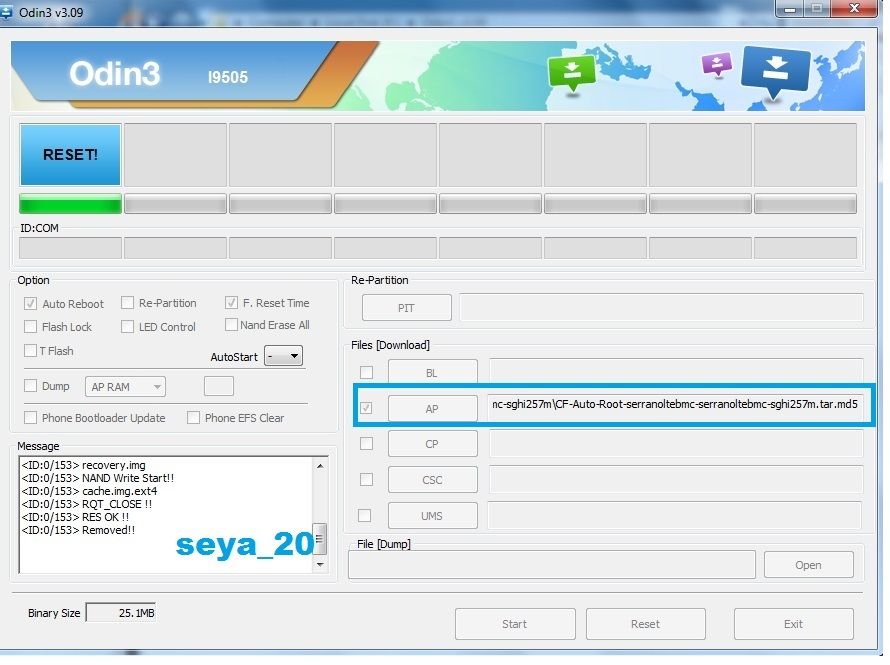

Root first
ito ginamit ko pang root
https://www.4shared.com/zip/3v4qjvX-ce/CF-Auto-Root-serranoltebmc-ser.html
then use odin 3.09
put your phone in dowload mode
then flash cf-autoroot file in AP/PDA
after rooting dial

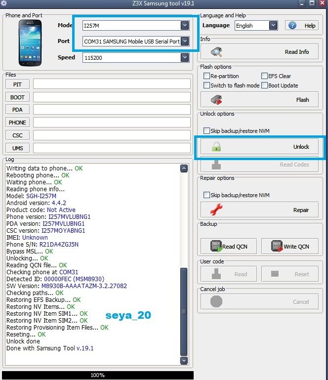

*#0808# and select DM+MODEM+ADB press OK
then connect usb cable in z3x
pero sa latest update ng z3x no need to root na
di kc activated un akin ;))
