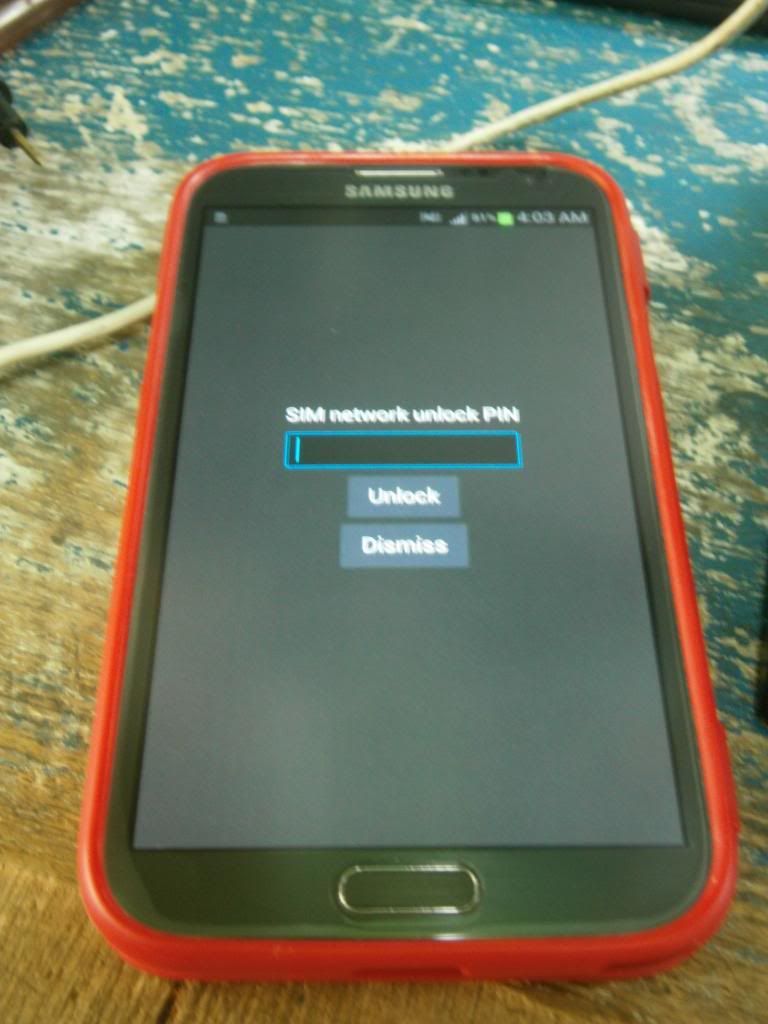

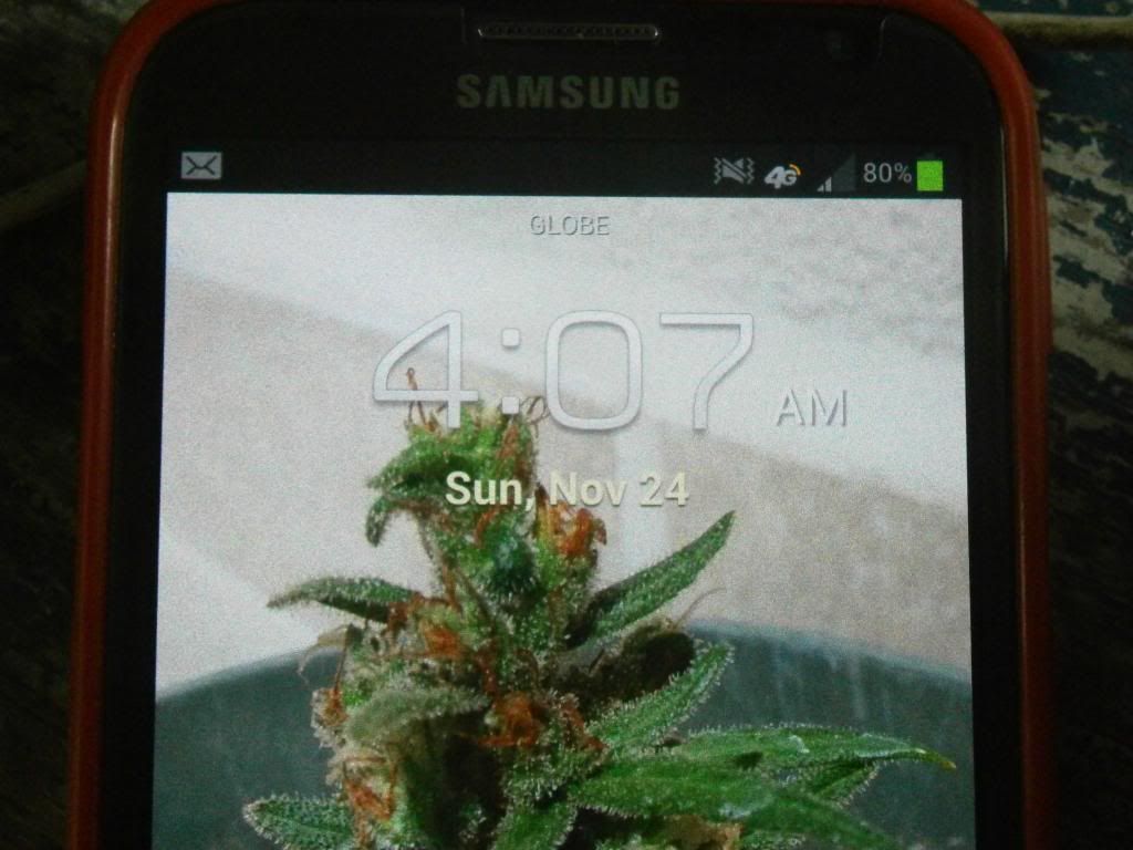

share ko lang po ito nagawa ko po mga bossing unlock po I317 (note 2)
naka lock po sa ATNT
To connect SGH-I317 phone you have to perform the following steps:
1. Disconnect USB cable from phone.
2. Go to Menu->Settings->Developer options.
3. Turn on "USB Debugging" option.
4. When message is appear press "Yes".
5. Go to dial window.
6. Enter "*#7284#" number.
7. Set "UART" radio button to "MODEM" value.
8. Go to "Qualcomm USB Settings".
9. Select "RNDIS+DM+MODEM".
10. Close window.
11. Go to dial window.
12. Press "Read Info" in software.
13. press " Read codes"
14. insert unaccepted simcard
15. then input codes
screen shots
